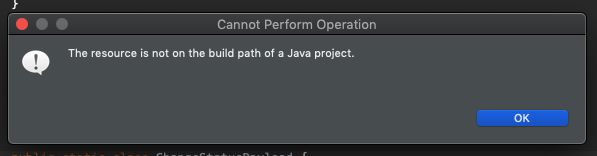

I am a complete Java/Gradle noob. I have Eclipse 2020 installed and working on simple hello world apps with some basic Gradle task. it works as expected.
But when I went to open our API repo, I am hitting this error every time I try to import a package, or even use a getter and setter generator. I have attached some images I feel are relevant.
PLEASE HELP
Re: PLEASE HELP! Build Path Error [message #1826288 is a reply to message #1826279] Wed, 22 April 2020 16:28 Go to previous message

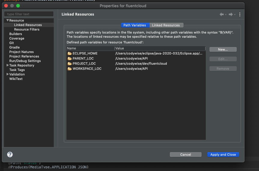

The error shown in Screen Shot 2020-04-22 at 11.20.43 AM.png occurs when you're working on a file that does not belong to a Java project. That can happen either when the file does not belong to any project or when the project does not have the Java nature. According to Screen Shot 2020-04-22 at 11.24.37 AM.png I would say that you're facing the latter.
I'm not use to Gradle at all but according to this article on using Gradle in Eclipse IDE I would say that your build.gradle is missing the following lines:
apply plugin: 'java'
apply plugin: 'eclipse'
Otherwise, could you explain precisely what you mean by "open our API repo" and "import a package" so that we know exactly what you've tried?
