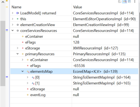

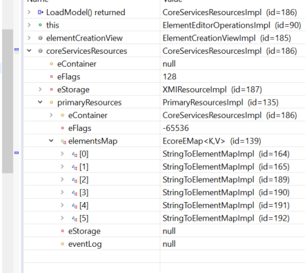

If I then add a new element, I see three elements in memory. I then save the model, and see three elements in the file.
I then load the file again, and now I see six elements in memory.
index.php/fa/37918/0/
If I add a new element and save, there are now seven elements in the file.

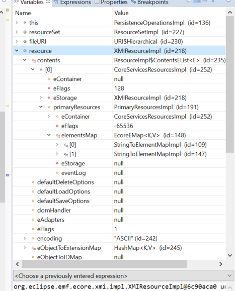

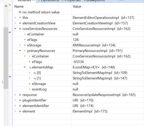

Here are the results of another debugging session, this time with a breakpoint in the StringToElementMapImpl constructor, as Ed suggested.
The file contains one element e1.
I load the file, and add element e2. At this point the model in memory looks like this:
index.php/fa/37919/0/
I save the model to file, and then load the file again.
I have a breakpoint inside the StringToElementMapImpl ctor, so I can check to see how the map is looking at this stage. It should be empty, but it is not:
index.php/fa/37920/0/
Interestingly, as German pointed out earlier, although the coreResources object is new, the primaryResources (and the elementsMap inside) have the same id. I don't know why that is - in our model coreResources has an EReference to primaryResources, and the Containment property is set to true.

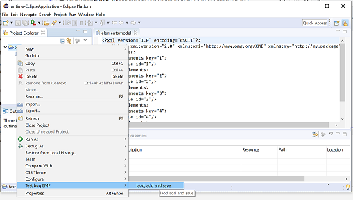

Your problem sparked my curiosity, so I made a small project trying to recreate your problem, you will find it attached to this post.
For me it is working as expected in EMF 2.20 and 2.21
I defined an ecore model similar to yours ... now I know how maps work in EMF :) .. and added a menu entry to start the test.
just right-click on a project and you will find the menu
index.php/fa/37923/0/
I copied a variation of your code in class test.mypackage.MyHandler, and made my own versions of adding to the map and saving.
Everything seems to be working as expected. Can you test my project in your configuration ?
