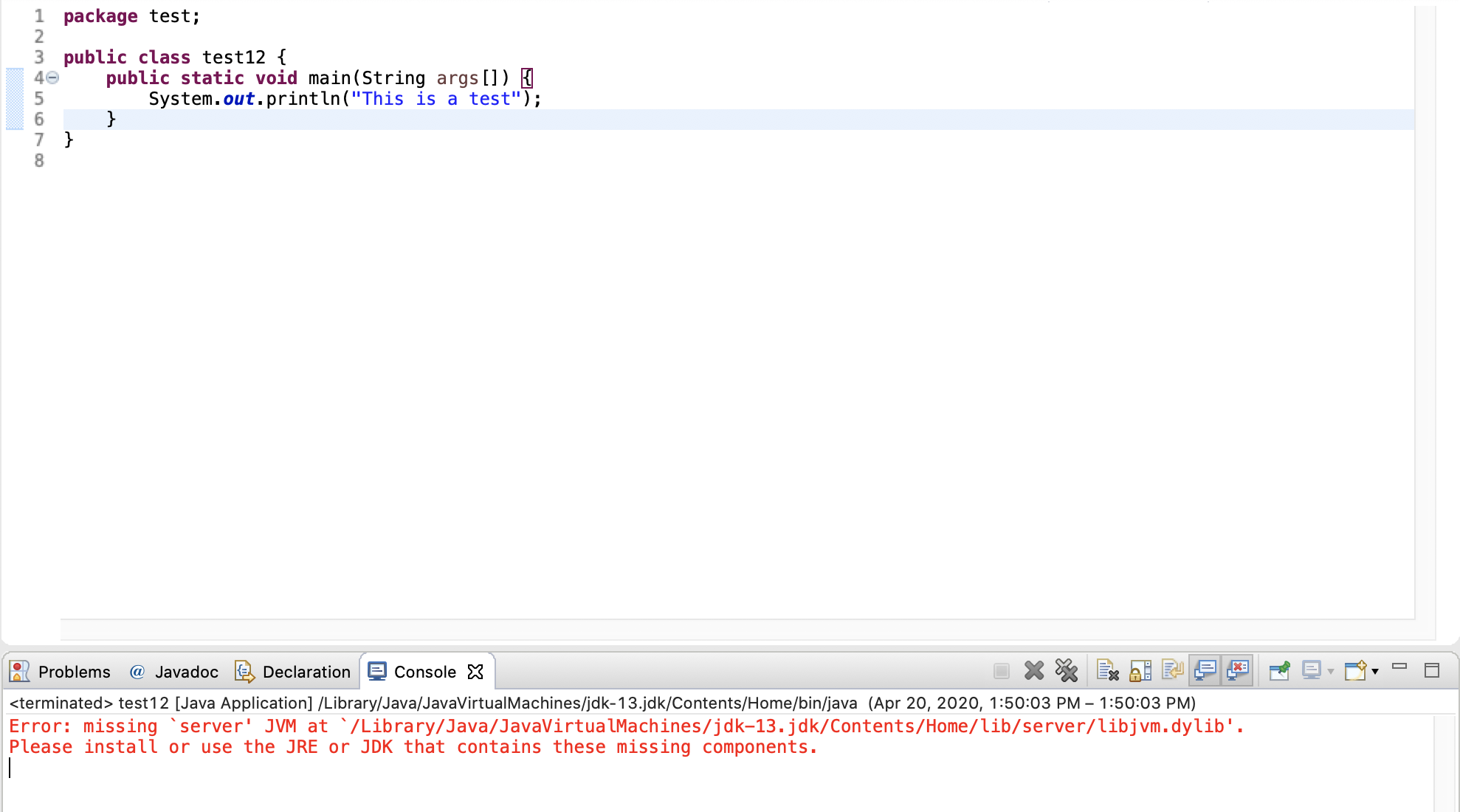

I am using a macOS 10.15.4 Catalina and have downloaded the jdk-13.0.2 and jdk-8u251 installation already, both on 64 bit. However, when I attempt to run a program in Eclipse I receive the error in console, "Error: missing `server' JVM at `/Library/Java/JavaVirtualMachines/jdk-13.jdk/Contents/Home/lib/server/libjvm.dylib'. Please install or use the JRE or JDK that contains these missing components." How may I resolve this issue? The screenshot is attached and please let me know if there is any other information that I can provide.

Is that file really missing, i.e., is there a /Library/Java/JavaVirtualMachines/jdk-13.jdk/Contents/Home/lib/server folder on your machine?
I know there is this bug open that might be related:
https://bugs.eclipse.org/bugs/show_bug.cgi?id=559482
This might be another case of there being a symbolic link needed that's actually packaged up as a copy of the library rather than as a symbolic link to the library.
