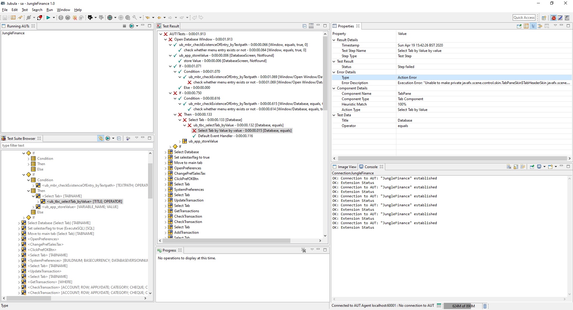

When trying to select a Tab in a TabPane I get the execution error:
Execution Error: "Unable to make private javafx.scene.control.skin.TabPaneSkin$TabHeaderSkin javafx.scene.control.skin.TabPaneSkin$TabHeaderArea.getTabHeaderSkin(javafx.scene.control.Tab) accessible: module javafx.controls does not "opens javafx.scene.control.skin" to unnamed module @667b9d74"
See enclosed images error200419.jpg and screen200419.jpg.
The test first checks the Window menu item to see if the window is already open and then selects the tab. This is the point of failure.
What is going on and how do I overcome it?
Thanks for the help.

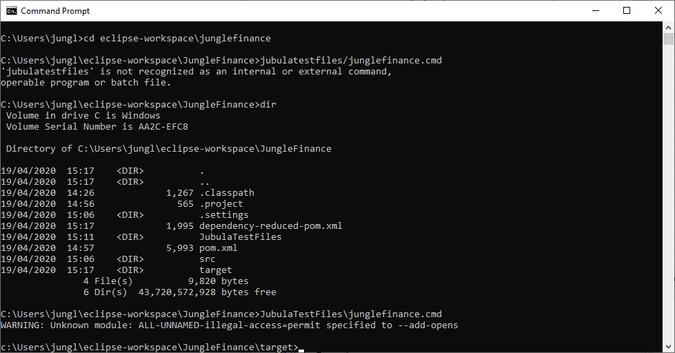

Re: Executing Javafx 11 [message #1826140 is a reply to message #1826132] Mon, 20 April 2020 03:47 Go to previous messageGo to next message
Hi Marvin, thanks for the quick reply. I have added it and received an error from Java (see error200420.jpg). I am executing Java 11.0.6 and using the enclosed cmd file (junglefinance.cmd)

Re: Executing Javafx 11 [message #1826143 is a reply to message #1826140] Mon, 20 April 2020 03:58 Go to previous messageGo to next message
Hi Marvin
After investigating the Java options I have found the issue, I cut and pasted the option from the release notes into my command file. There is a missing space and -. It should read '--add-opens=javafx.controls/javafx.scene.control.skin=ALL-UNNAMED --illegal-access=permit'. This worked.
Mike
