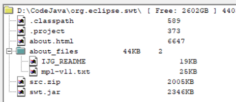

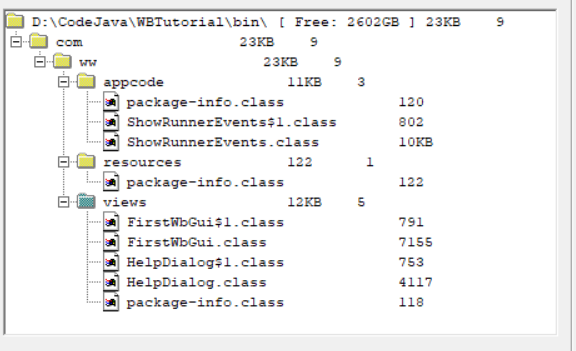

Sorry I'm a noob [message #1826098 is a reply to message #1826090] Sun, 19 April 2020 10:16 Go to previous messageGo to next message
I'm a noob to java and eclipse. Not to programming - did that for 50 years at this point - but I got "Context Menu" but lost you with everything else.
Here is what is in the app bin folder tree and there is another tree that might be interesting here called org.eclipse.swt.
So is there a web page somewhere that walks me through what to do with these to make a "Deployable" java application?

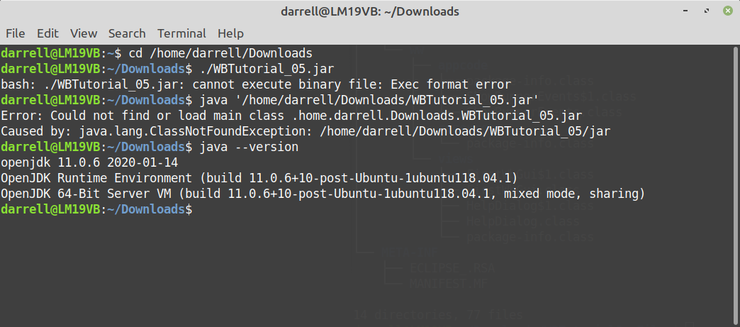

On Linux Mint, not so much [message #1826101 is a reply to message #1826099] Sun, 19 April 2020 11:21 Go to previous messageGo to next message
Didn't work on Linux.
Installed the default java that comes with Linux Mint 19.3.
Here's what I got. Any idea what's wrong?
~/Downloads$ java '/home/darrell/Downloads/WBTutorial_05.jar'
Error: Could not find or load main class .home.darrell.Downloads.WBTutorial_05.jar
Caused by: java.lang.ClassNotFoundException: /home/darrell/Downloads/WBTutorial_05/jar
As a reminder, the same jar file ran just fine on Windows 10.
Thanks.

Re: On Linux Mint, not so much [message #1826102 is a reply to message #1826101] Sun, 19 April 2020 12:01 Go to previous messageGo to next message
Ooooooookkkkkkkkkaaaaaayyyyyy...
That's surprising. I made another version and did not choose the "Runnable Jar File" option and I got this:
 darrell@LM19VB:~/Downloads$ java -jar WBTutorial_06.jar
no main manifest attribute, in WBTutorial_06.jar
darrell@LM19VB:~/Downloads$ java -jar WBTutorial_05.jar
Error: LinkageError occurred while loading main class com.ww.appcode.ShowRunnerEvents
	java.lang.UnsupportedClassVersionError: com/ww/appcode/ShowRunnerEvents has been compiled by a more recent version of the Java Runtime (class file version 57.0), this version of the Java Runtime only recognizes class file versions up to 55.0
So, surprise one. Java is stupid. At least stupider that I would have thought. You hand it a JAR file and it apparently needs a -jar. Who knew? I would have figured that it looked at the file and could tell, even if it ignored the .jar. So anyway, you can't launch a file without -jar apparently.
Now we get to the real error.
(1) You need to build it as a RUNNABLE JAR FILE to get the correct manifest entry for MAIN. Ok. Good to know.
(2) I need to install the same version of Java on this system. Even as recently as the one default installed for Linux Mint 19.3 is not new enough. But then that should solve the problem
Back in a little while some success, I hope.
