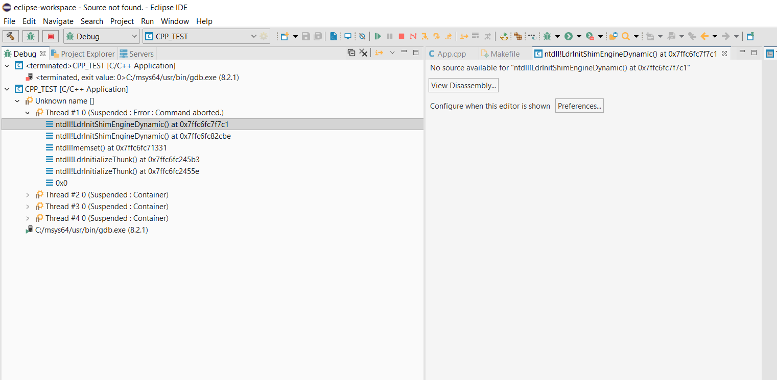

I am trying to debug a very simple Hello World application with Eclipse IDE for C/C++ Developers Version: 2020-03 (4.15.0).
I tried an own Makefile project and the CDT managed build. In both cases
i get the following errors in dthe debugger. Running works without issues:
Thread #1 0 (Suspended: Error: Command Aborted)
Does anyone have an idea why gdb does not work?

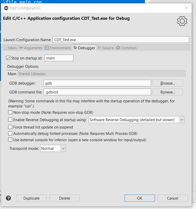

I attached the error and the gdb settings.

No one else has this issue? I am now ussing the gdb.exe (C:\msys64\mingw64\bin\gdb.exe) for 64 bit binaries (I thoughtthat might have been a solution), but I still can't use gdb in eclipse because of this issue, but it works from the command line..

UPDATE: problem is occurring in NTDLL.
https://www.processlibrary.com/en/directory/files/ntdll/23004/
This looks like a problem with MinGW gdb and not Eclipse.
Googling "ntdll LdrInitShimEngineDynamic mingw gdb" turns up a number of related problems.

The basic problem is that gcc and gdb are not from the same release. For whatever reason, gdb is essentially located in two places: it is part of binutils (located at c:\msys64\usr\bin) and part of the 64-bit compiler release (located at c:\msys64\mingw64\bin). The 64-bit gcc compiler is not compatible with the 32-bit (?) gdb located in binutils. This all comes about because make (an independent package) is also located in c:\msys64\usr\bin. Make is required to build Makefile based projects, thus must be on the path. In the past, I believe this was not an issue.
Make sure that the PATH variable is like this: c:\msys64\mingw64\bin;c:\msys64\usr\bin. This can be done as a win10 environment variable or set in the eclipse CDT project environment. Note that the compiler directory is before the make directory. In the current release of msys2, the version of gdb in c:\msys64\usr\bin is not compatible with the gdb that is shipped with the compiler (c:\msys64\mingw64\bin). The order of these directories is critical and ensures that the gcc and gdb come from the same directory. There is an issue opened on msys2 for this, it is: https://github.com/msys2/MSYS2-packages/issues/2361

Solved it by making sure to use gdb from C:\msys64\mingw64\bin instead of C:\msys64\usr\bin.
Right click on Project -> Properties -> "C/C++ Build" -> Environment
Set or add Variable PATH to
${MINGW_HOME}\bin
First directory in list gets priority over other entries in the list. So make sure ${MINGW_HOME}\bin comes before ${MSYS_HOME}\usr\bin if both are required.
