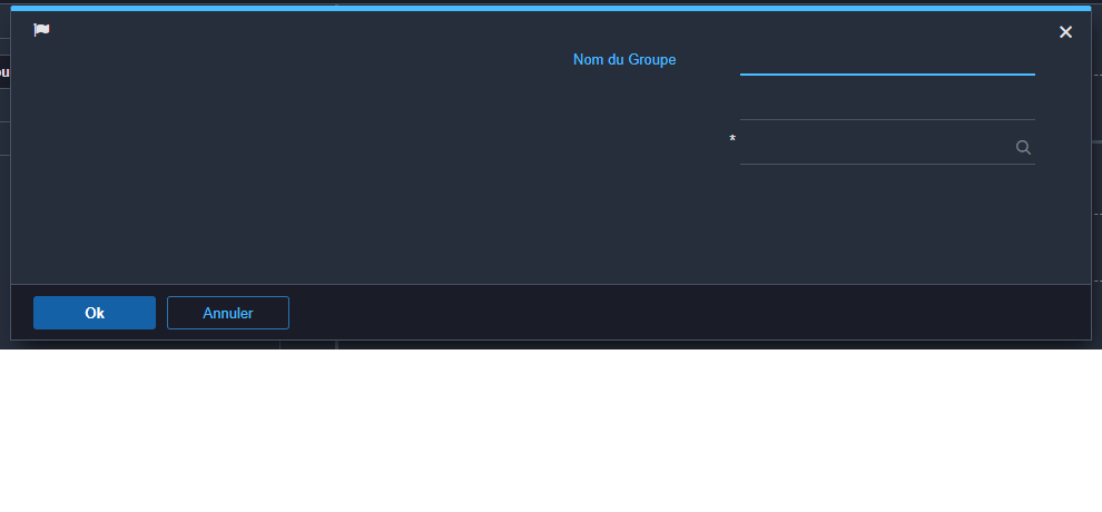

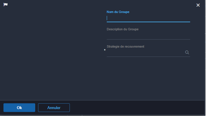

I have a form that loads like this
index.php/fa/37811/0/Hello,
I would like to change it so that it look like this when loading
index.php/fa/37812/0/
this is a resizing ( manuelly done.)
Witch property do this layout ?

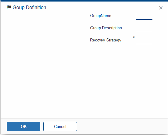

Re: Forum Layout in Scout [message #1824390 is a reply to message #1824388] Tue, 14 April 2020 13:10 Go to previous messageGo to next message
I have already tried that but it does not give the same result it overlap the fields and gives an bad result.
I will upload an image
Re: Forum Layout in Scout [message #1824392 is a reply to message #1824382] Tue, 14 April 2020 13:13 Go to previous messageGo to next message
result using getConfiguredWidthInPixel()
index.php/fa/37818/0/

Re: Forum Layout in Scout [message #1824398 is a reply to message #1824392] Tue, 14 April 2020 13:56 Go to previous message
I assume you mean the position of the labels? You can just set the getConfiguredLabelPosition() of the form fields to LABEL_POSITION_TOP.
