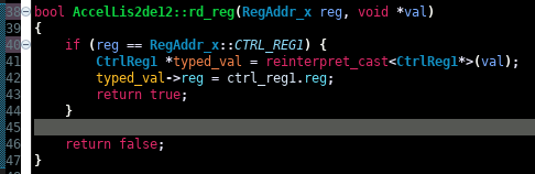

I changed your code to use a typedef and changed the name to RegAddr_x just to be unique.
That is, typedef enum class AccelLis2de12::RegAddr : uint8_t { ... } RegAddr_x;

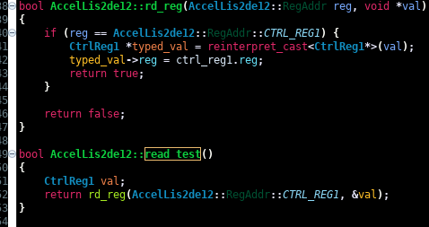

All references to the enum must be qualified thusly, AccelLis2de12::RegAddr
Full qualification is not necessary within member definitions but safer.
index.php/fa/37825/0/
It's possible to use the typedef instead.
index.php/fa/37826/0/
