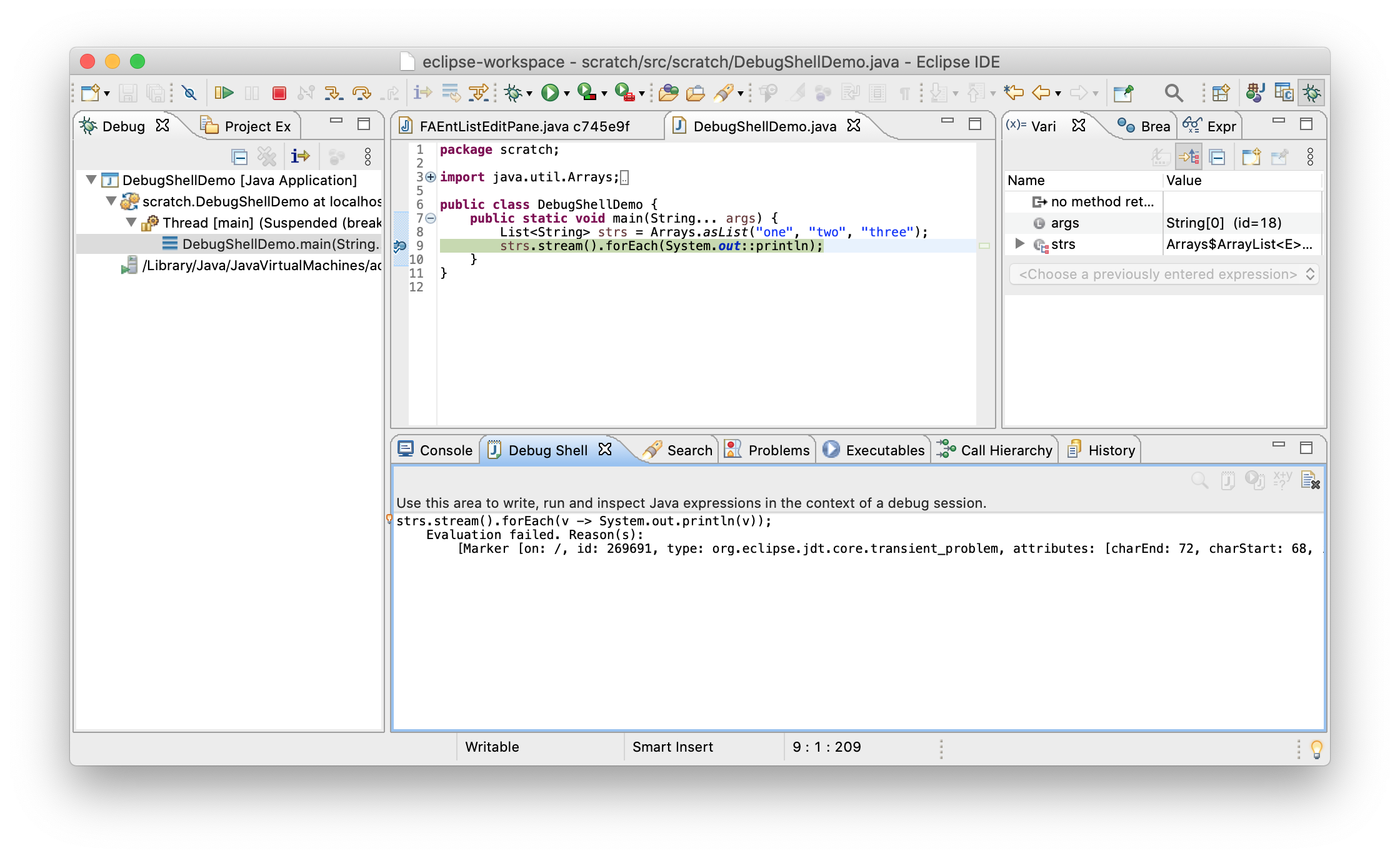

Consider this simple demo:
package scratch;
import java.util.Arrays;
import java.util.List;
public class DebugShellDemo {
    public static void main(String... args) {
        List<String> strs = Arrays.asList("one", "two", "three");
        strs.stream().forEach(System.out::println);    // breakpoint here
This code runs without error. But if I run it in the debugger and break at the indicated line, and then try to execute that line in the Debug Shell, I get this error:
	Evaluation failed. Reason(s):
		[Marker [on: /, id: 269688, type: org.eclipse.jdt.core.transient_problem, attributes: [charEnd: 67, charStart: 63, id: 33554502, lineNumber: 1, message: java cannot be resolved or is not a field, severity: 2, sourceId: JDT], created: 4/13/20, 9:03 AM]]
Everything else seems to be OK -- autocomplete works, for example, and if I instead evaluate a stream pipeline with a collector, I get the expected result:
strs.stream().map(e -> e).collect(java.util.stream.Collectors.toList())
	 (java.util.ArrayList<E>) [one, two, three]
Am I doing something wrong, or is this a bug?
I'm using Eclipse 2020-03 on macOS 10.15.4, but this also happens in Windows 10.

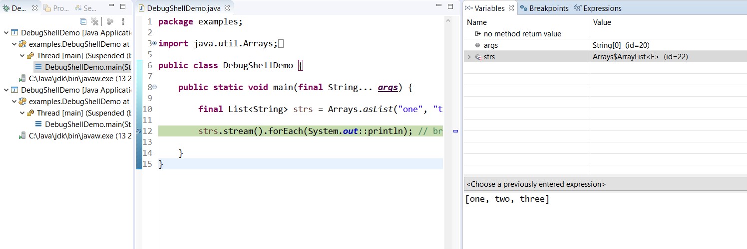

Re: Debug Shell Evaluation Failure with Stream Processing [message #1824312 is a reply to message #1824309] Mon, 13 April 2020 13:42 Go to previous messageGo to next message
Hello there,
No problems at this end.
Using:
- Windows 10.
- Eclipse IDE for Java Developers 2020-03 (4.15.0)
- openjdk version "14" 2020-03-17
index.php/fa/37807/0/
Re: Debug Shell Evaluation Failure with Stream Processing [message #1824315 is a reply to message #1824312] Mon, 13 April 2020 14:05 Go to previous messageGo to next message
Thanks, Eitan, but I'm talking about Debug Shell specifically:
index.php/fa/37808/0/
