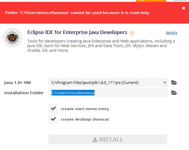

I have tried to create a new folder but it will not let me install it there because it is 'ready only'. How to get pass that? I have deleted the folders. You can see the image attached.

You don't have write access to C:\Users nor would I expect you've have such write access. Don't install to a folder for which you don't have write access. Install into your real home folder or to some disk location where you have write access.
