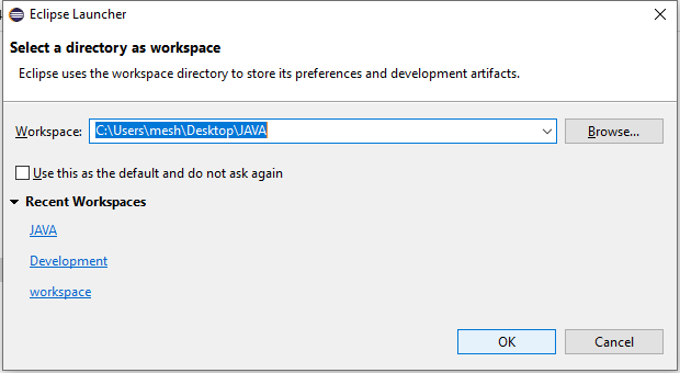

Installation Problem [message #1823976] Sun, 05 April 2020 17:47 Go to next message
I am trying to install Eclipse. I don't get at all far and the install produces and error and log file. I don't understand the log file. I am installing under Windows 10. I have jdk 13.2. I look forward to an easy resolution..

Re: Installation Problem [message #1823979 is a reply to message #1823976] Sun, 05 April 2020 21:09 Go to previous message
It reads as though you're trying to install a 3 year old release, Neon.1, and use it with a much newer JDK
release. They don't work together like that. You should use at least Oxygen.1 to run with anything newer
than Java 8. Preferably, you should use the current release, 2020-03, since Java 13 existed while it was
being made.
