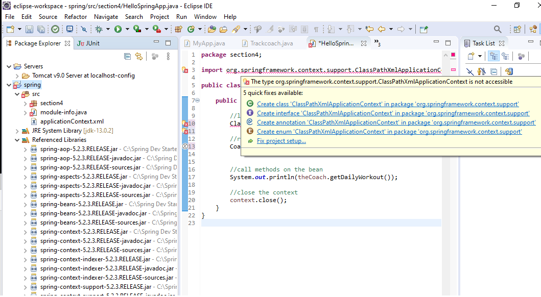

Hey Guys,
Hoping to get a lil help. I am finding with nearly any package I am importing I am always coming across the "X is not accessible" even when going through tutorials and following it to the letter.
Have experienced this with attempting to run a simple Junit test and with trying to start a basic spring file by calling ClassPathXmlApplicationContext.
Right now I am attempting to import ClassPathXmlApplicationContext but I am getting that it is not accessible.
I have:
* Declared the import org.springframework.context.support.ClassPathXmlApplicationContext;
* Configured build path > library > Classpath > Add External jars > and selected all JARs provided. (have also tried copying them all into a folder in my eclipse project and then using Add Jar instead External jar. Same outcome
Any advice would be really appreciate and if need more info happy to provide. Have included a screenshot to show folder setup and error.
Sean
Re: Import not accessible [message #1823977 is a reply to message #1823966] Sun, 05 April 2020 21:05 Go to previous messageGo to next message
Delete the module-info.java file. It's only used if you're using Java's built-in module system.
Re: Import not accessible [message #1828905 is a reply to message #1823977] Sun, 21 June 2020 16:59 Go to previous messageGo to next message
Thank you! Works a charm :)
Re: Import not accessible [message #1871847 is a reply to message #1823977] Sun, 13 October 2024 19:36 Go to previous messageGo to next message
Thank you from 15 years later. I was losing my mind with this crap. What an odd problem to the situation.
