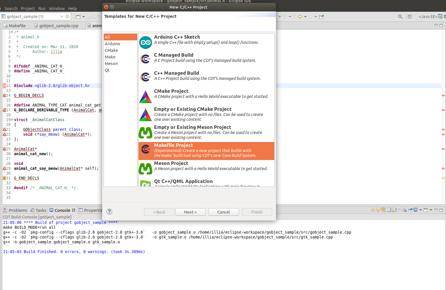

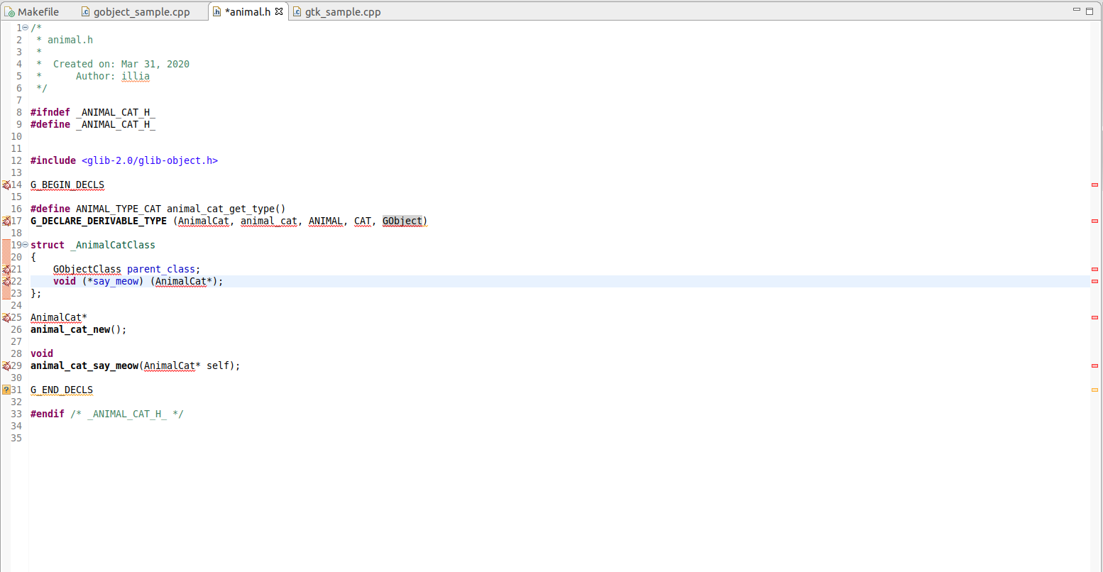

After I created a Makefile project to play around with glib and GObject I'm having this issue. Eclipse shows that GObject could not be resolved, when the header file
#include <glib-2.0/glib-object.h>
for it is resolved. here is the screenshots

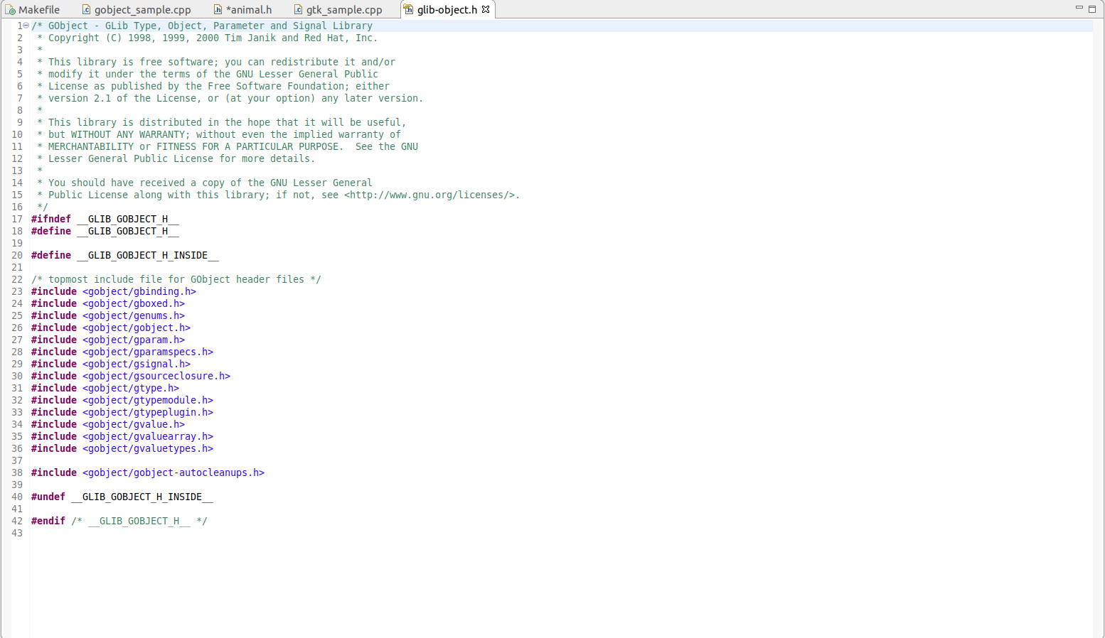

I also able to go by link and open glib-object.h header file in eclipse, so I assume it resolved,
index.php/fa/37734/0/

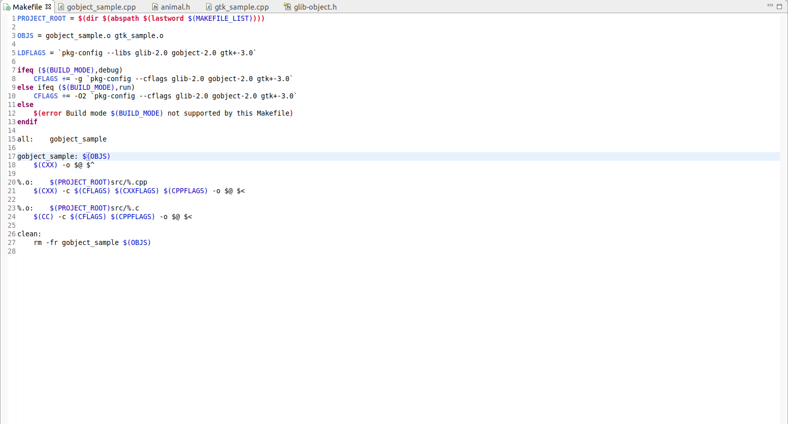

as well as I'm able to build the project using eclipse, here is my makefile:
index.php/fa/37735/0/

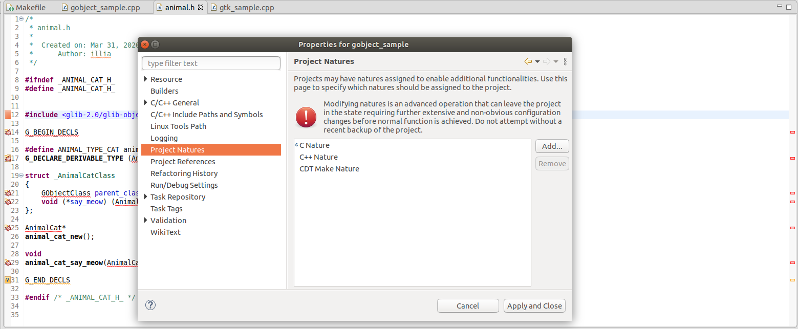

I tried to check your suggestion, but at first point I found that my project settings doesn't contain C/C++Build entry, than I compared it with another project in my workspace that doesn't use glib and works fine, and I found that it has C/C++Built entry in project properties. So I checked the project nature and found this
index.php/fa/37741/0/
The reason why is that so it's because I created project using Makefile configuration which is stated as Experimental
index.php/fa/37742/0/

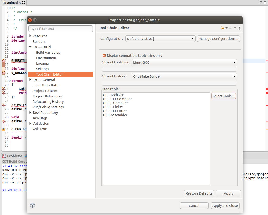

So I recreated the project as C/C++ Managed Build and than mentioned by you properties appeared.

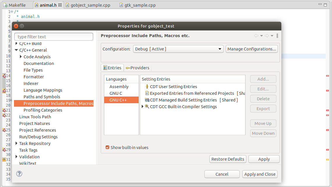

index.php/fa/37743/0/
index.php/fa/37744/0/
But the initial problem still presents. I don't know, maybe I miss something, but to me it looks like all tools is set and includes are in place.
