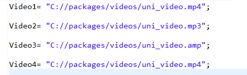

Re: Xtext grammar to Java Code [message #1823626 is a reply to message #1823623] Mon, 30 March 2020 09:08 Go to previous messageGo to next message
Yes, I follow the same link but when I reached the 15 Minutes extended tutorial then things are hard for me to understand as well as compare.
Code should be look like this.
Public String="Any Path in here";
  • Attachment: Capture.PNG
    (Size: 6.97KB, Downloaded 74 times)
Re: Xtext grammar to Java Code [message #1823630 is a reply to message #1823626] Mon, 30 March 2020 10:05 Go to previous messageGo to next message
this should be straight forward from the tutorial
i change the grammar to assign the string. am not sure if this is a C&P error
video:
name=ID "=" value=STRING

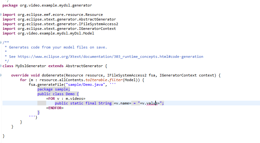

Re: Xtext grammar to Java Code [message #1823647 is a reply to message #1823630] Mon, 30 March 2020 13:35 Go to previous messageGo to next message

Re: Xtext grammar to Java Code [message #1823648 is a reply to message #1823647] Mon, 30 March 2020 13:52 Go to previous messageGo to next message
did you change the grammar as proposed?
Re: Xtext grammar to Java Code [message #1823649 is a reply to message #1823648] Mon, 30 March 2020 13:55 Go to previous messageGo to next message
yes, have a look.
grammar org.video.example.mydsl.MyDsl with org.eclipse.xtext.common.Terminals
generate myDsl "http://www.video.org/example/mydsl/MyDsl"
Model:
(videos+=video)*;
video:
name=ID "=" value=STRING;
Re: Xtext grammar to Java Code [message #1823652 is a reply to message #1823649] Mon, 30 March 2020 14:14 Go to previous messageGo to next message
if you regeneate the language by running the workflow and or do a clean build on the project
then this should work. in doubt open and close the editor
Re: Xtext grammar to Java Code [message #1823653 is a reply to message #1823652] Mon, 30 March 2020 14:15 Go to previous messageGo to next message
Thank you.
It's working now. Do you have any blog which I can follow?

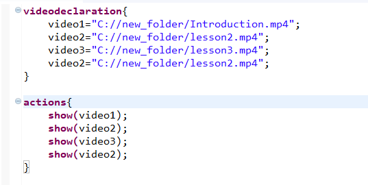

The code should look like this.
  • Attachment: xtext.PNG
    (Size: 12.10KB, Downloaded 83 times)
Re: Xtext grammar to Java Code [message #1827194 is a reply to message #1827188] Sun, 10 May 2020 04:46 Go to previous messageGo to next message
This is the model file and not the java file you want to generate out of it

Re: Xtext grammar to Java Code [message #1827249 is a reply to message #1827246] Mon, 11 May 2020 09:05 Go to previous messageGo to next message
Now let me explain in detail.
I have different variables and all are in video declaration(see the grammar and attached picture). Now I want to create a function that takes the variables as in the same order they are defined. I am finding difficulty in writing the code for the function. You can also see the grammar and modify it as per your need.
    (Size: 12.10KB, Downloaded 73 times)
[Updated on: Mon, 11 May 2020 09:45] by Moderator
Re: Xtext grammar to Java Code [message #1827255 is a reply to message #1827249] Mon, 11 May 2020 10:58 Go to previous messageGo to next message
i still dont understand your question:
both have a list
so you can ask a Video object for videos (getVideos())
and a Videouse for viduse (getViduse())
which are both ordered as declared.
starting from
Model:
parts+=ModelPart*
you can either filter the parts for Video or Videouse using model.getParts().filter(Video)
of you use instanceof
