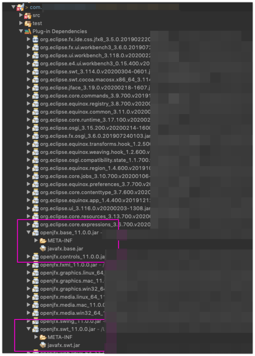

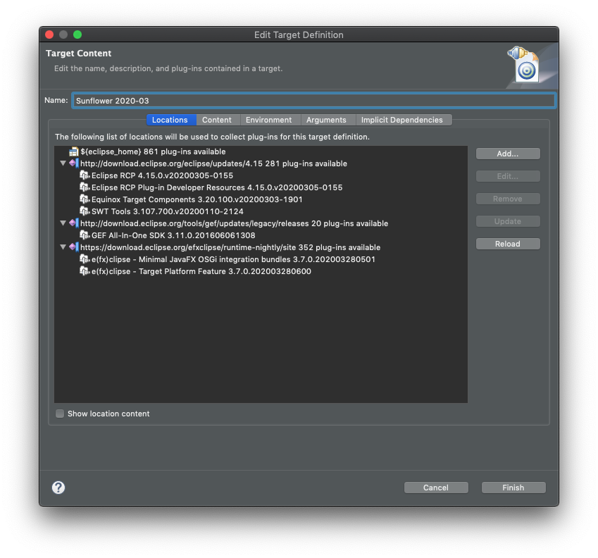

The one sticky point is I'm not quite sure how to leverage the p2 repository for for OpenJFX 11 that Tom has hosted at bestsolution.at. When I add the modules into the Target Platform, the JAR files seem to get bundled, however only as files, not as libraries, so none of the classes seem to be imported into the platform. Added these modules as plug-in dependencies adds the files into the plug-in's library References, however when I dig into the library, all I see is the raw OpenJFX jar file and none of the classes.
So I'm unclear how to get OpenJFX, specifically the javafx.swt, which is platform dependent into the build. Ideally I'd like to use the latest OpenJFX, but can use OpenJFX 11 if that's all that works.

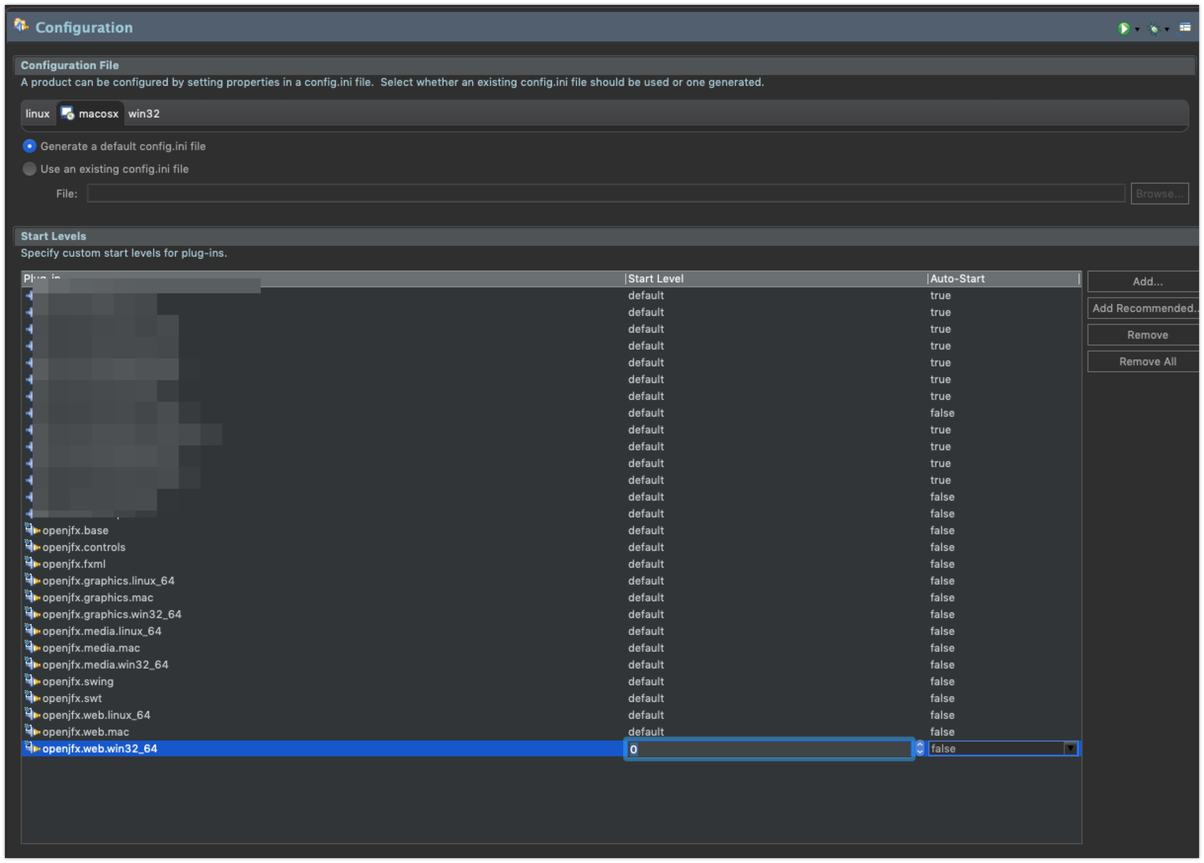

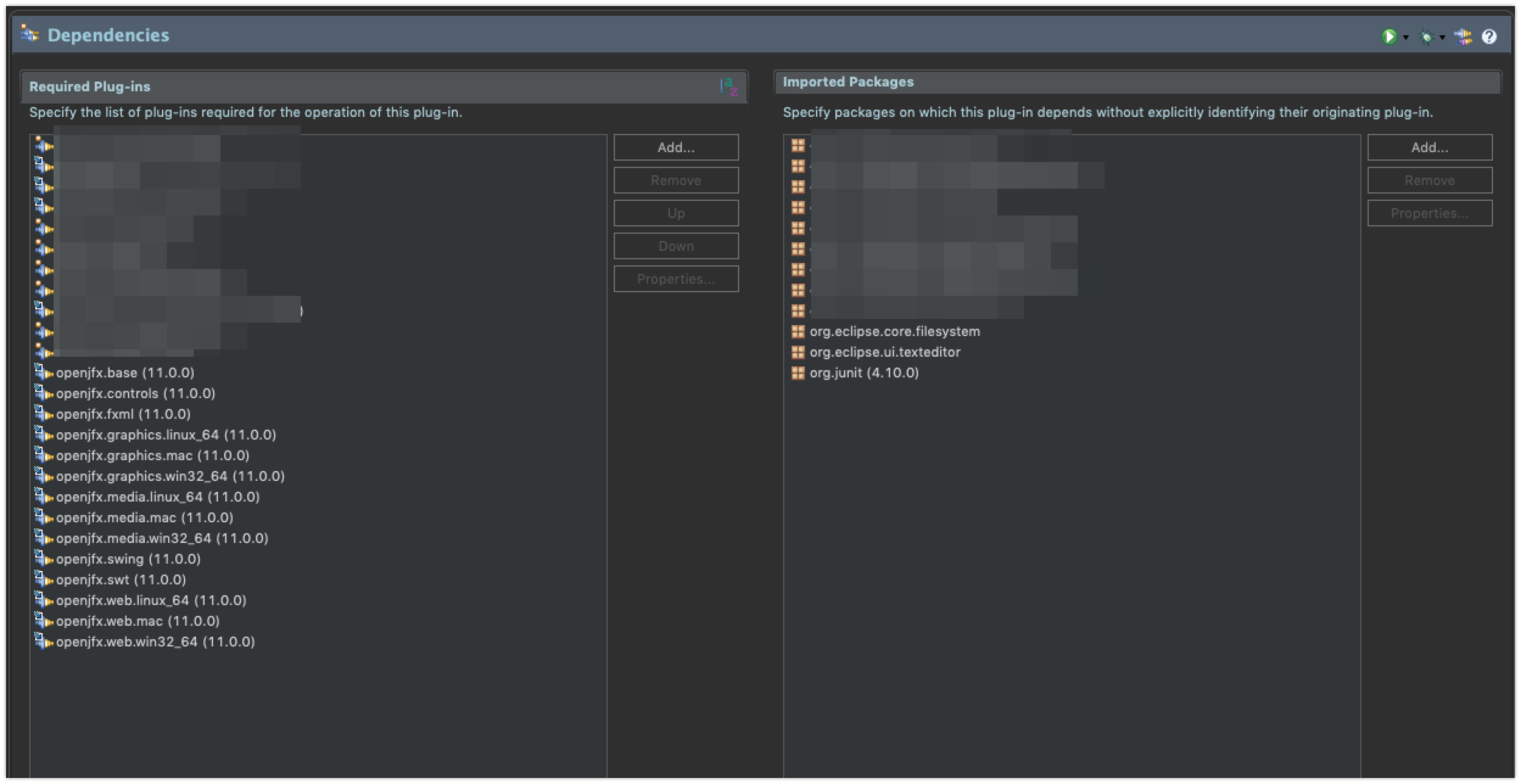

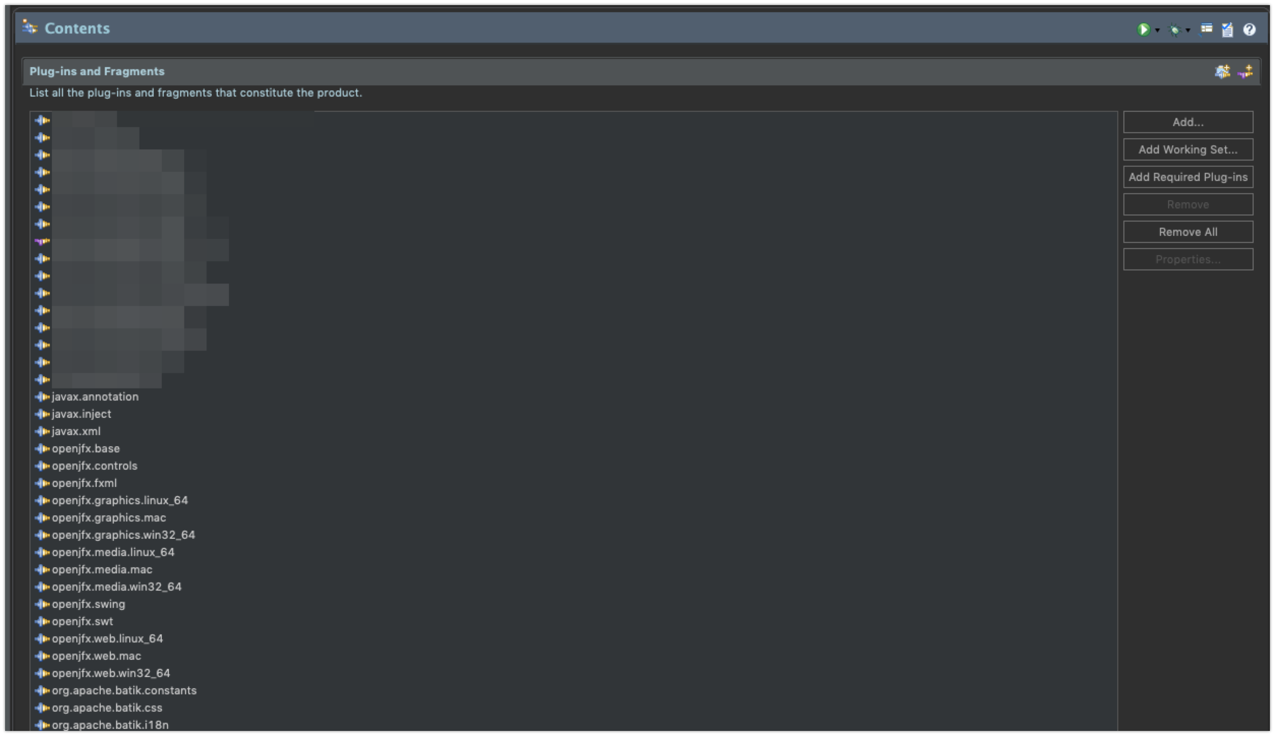

index.php/fa/37680/0/
index.php/fa/37681/0/
index.php/fa/37682/0/
index.php/fa/37683/0/

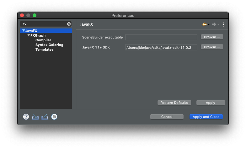

regarding JFX-SDK: index.php/fa/37690/0/

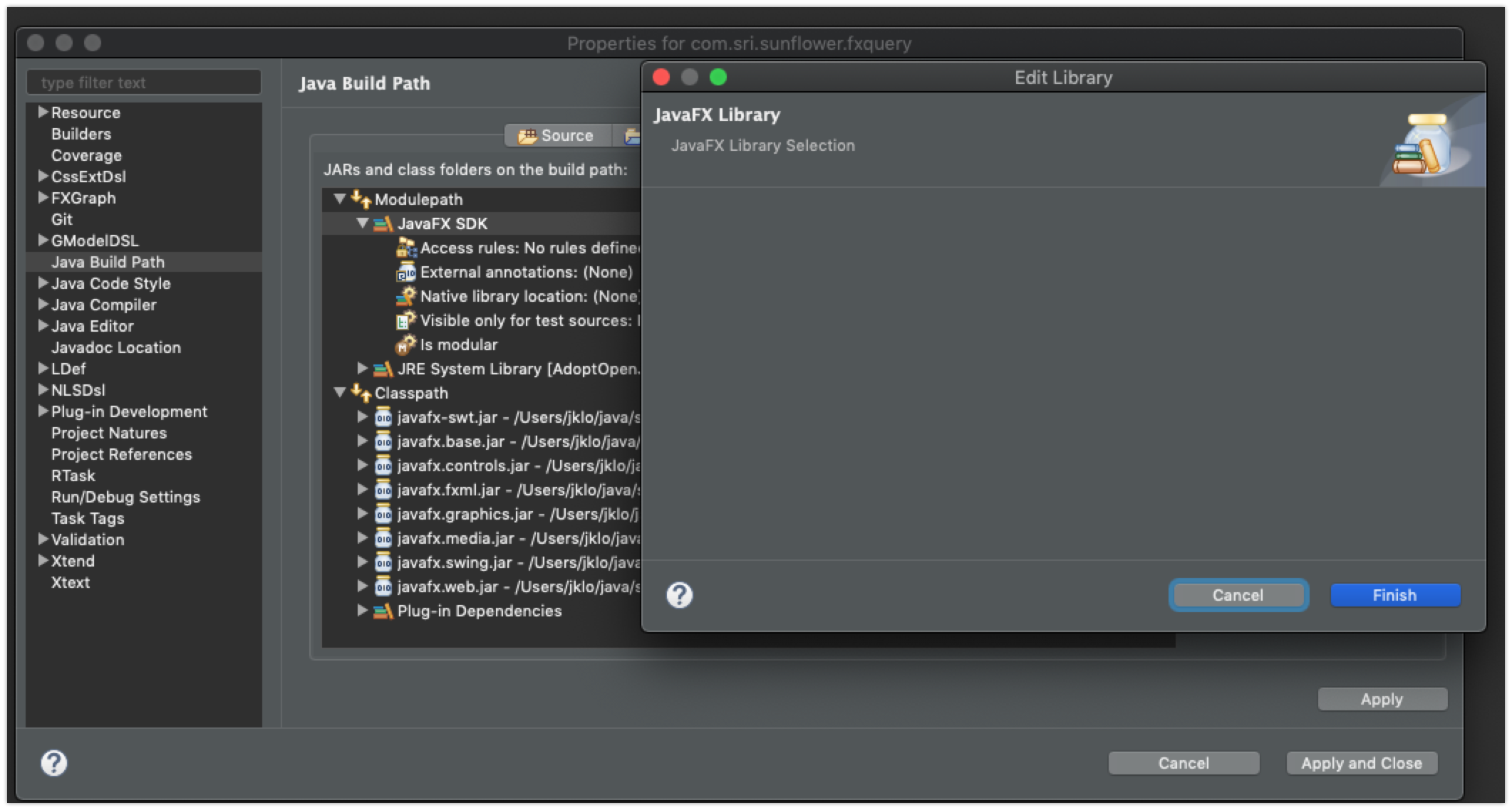

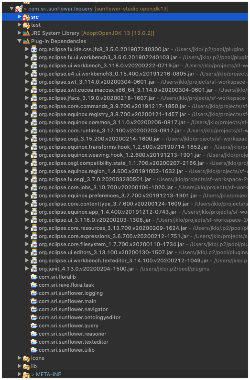

I'm not sure how to get the javafx libraries to show up on the classpath. When I go configure the classpath.... There's nothing to select in the JavaFX Library:index.php/fa/37687/0/
The only way I can get them somewhat on the classpath is by adding them as an external jar, but I don't think that's what I want. I'm thinking they should show up under "Plug-in Dependencies" and not "Referenced Libraries".

Ok this looks like a bug in the tooling - https://github.com/eclipse-efx/efxclipse-eclipse/issues/73 if I set the EE (Execution Environment) to 11 then it works if I set it 13 then it fails
