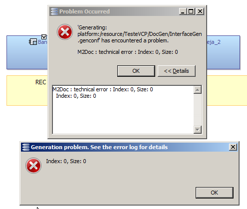

whenever I command a document generation by clicking on "Generate Documentation" I get the error message below with the details also pictured below.
index.php/fa/37672/0/
This happened before but the problem went away without any special action from me. This time the problem persits although I have closed everything, restarted the computer and deleted the old generated docx.
Do you guys have any clue what might be happening?

I searched for the error log and all I could find in my workspace that seemed like an error log was in the .metadata folder in the workspace root with the name '.log'.
I've attached it to thist post.
It seems the log regarding the errors on M2Doc generation is in the following lines:
!ENTRY org.obeonetwork.m2doc.genconf.editor 4 4 2020-03-26 20:34:00.900
!MESSAGE M2Doc : technical error : Index: 0, Size: 0
!STACK 0
java.lang.IndexOutOfBoundsException: Index: 0, Size: 0

After looking at M2Doc code, it seems that one of the metamodel your are using can't be found. Your should open the template properties using the wizard and in the nsURI tab make sure all the metamodel you are using are available.
I see a lot imported metamodels, you should probably remove some of them. A good starting point is probably to keep *capella* and *sirius* and maybe *thales* also. From here see if the template works or if it complains about missing types and add metamodels accordingly.
I don't have the same environment as you so I can't tell which one exactly.
