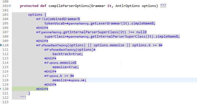

Bad I cannot include snapshots here, but here is the code sniplet from AbstractAntlrGrammarGenerator (sorry for the bad characters):
	protected def compileParserOptions(Grammar it, AntlrOptions options) '''
		options {
			�IF !isCombinedGrammar�
				tokenVocab=�grammarNaming.getLexerGrammar(it).simpleName�;
			�ENDIF�
			�IF grammarNaming.getInternalParserSuperClass(it) !== null�
				superClass=�grammarNaming.getInternalParserSuperClass(it).simpleName�;
			�ENDIF�
			�IF isParserBackTracking(options) || options.memoize || options.k >= 0�
				�IF isParserBackTracking(options)�
					backtrack=true;
				�ENDIF�
				�IF options.memoize�
					memoize=true;
				�ENDIF�
				�IF options.k >= 0�
					memoize=�options.k�;
				�ENDIF�
>>>>		�ENDIF�
	protected def isParserBackTracking(Grammar it, AntlrOptions options) {
		options.backtrack

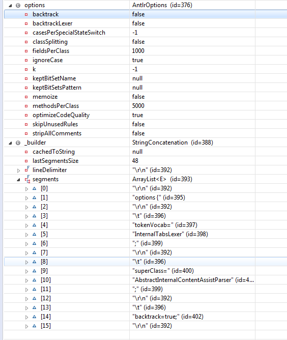

When you come to the point marked with ">>>>" the output is (copied from variable _builder.segments[]:
, options {,
, 	, tokenVocab=, InternalTabsLexer, ;,
, 	, superClass=, AbstractInternalContentAssistParser, ;,
, 	, backtrack=true;,  !!!!!!!!!!!!!!!!!!!!!!!!!!!!!!!!!!!
Which is an error according to debugged variable options.backtrack which is false
so isParserBackTracking(options) should never return true!
Had this xtend error before in normal xtend code with nested ifs. If you insert "{}" after the condition everything is fine, if not sometimes it goes into the nested if, even if the condition is false.

Re: Cannot set backtrack to false [message #1823375 is a reply to message #1823370] Wed, 25 March 2020 12:42 Go to previous messageGo to next message
if you debug you can click on the stackframe with the xtend file and select show source -> java from the context menu
then you should be able to see who adds the backtrace=true to the _builder/StringConcatenation
you can also debug the getter and setter in org.eclipse.xtext.xtext.generator.parser.antlr.AntlrOptions
(rightklick, open generated file to see the java code)
to see who calls setBacktrack with true
