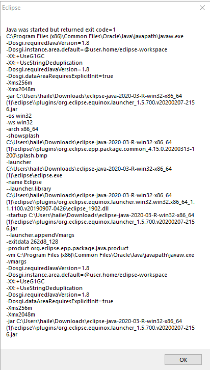

Hi, so when I try to download Eclipse it gives me a error, the error is:
"Java has started but returned exit code = 1
C:Program files (86x)\commonfiles\oracle\Java\JavaPath/Jawaw.exe
- Dosgi.requirejavaversion= 1.8
- Dosgi.instance.area.default=@user.home/eclipse-workspace" Ill upload the rest of the error as a screenshot

Yes, the installer checks the system for installed versions of Java and will either use a correct one (while offering choices of all available correct ones), or will tell you to install a correct one. It's clear that above you are using a 32 bit version of Java installed in C\:Program Files (86x)\ whereas a 64 bit version would be installed in C:\Program Files\. The latest Eclipse versions no not support 32 bit anymore.

Just must install a 64 bit version of Java. The installer brings up this page:
