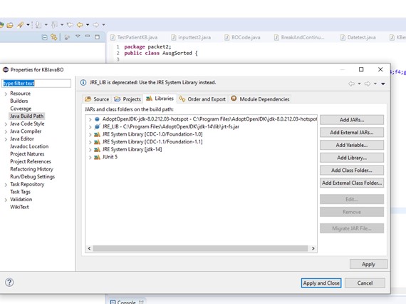

I am trying to learn autonmously Java based on Eclispe 9.6 and I have two Windows 10 computers both equipped with identical Eclipse and separate local workspaces on their harddrives and try to keep them up to date through (1) USB stick and/or Dropbox (2). At the end of the day (since months) each time the data transfer is a mess and I have not understood why (error message main class not found, Java.lang missing) occurs. Current Eclipse version is 201906 with ID 20190614-1200. The different JREs and JDKs I tried to enlarge to variable pathes according to the attached screenshot without auccess. I have read one eclipse book from Thomas Kuenneth, but did never find a sound and structured explanation of how (classpath, libaries, JAR files) should be arranged to get it work for 2 different PCs. Can anybody provide me sound and simple approach or a tutorial with practical examples to resolve my issue (main class not or missing reference to JAVA.lang, or imports not found?) I am willing to follow any concept, do any re-arrangement. Thanks in advance.

Dear Ed,
here attached you can see an exemplary snapshot of my classpath folder (snpashot attached). I think it contains references to JRE containers as wished/intended. Does it? On the 2nd PC (not used for this snapshot the jdk-8.0212.03 works fine for all JAVA source coudes generate on this machine. Therefore I loaded this JDK version up via Build path/external JARs to reslove my problem on this computer. Obviously without success. Can you provide some regerences/indications on which locations I need to impelement portable references. Can you recommend any book/tutorial that is sufficently detailed/conrete with example.

You have several JRE_CONTAINER entries. But for very reduced version of Java. Is that intentional? Normally one just has an entry like this:
	<classpathentry kind="con" path="org.eclipse.jdt.launching.JRE_CONTAINER/org.eclipse.jdt.internal.debug.ui.launcher.StandardVMType/JavaSE-1.8"/>
And that makes everything in the JRE visible on the classpath. You can see what that is via Window -> Preferences -> Java -> Installed JREs and using Edit... to see the details. Aren't all the libraries you want visible there already?
But I see you've also got a module-info.java so you're using Java 9 or higher (or trying to, but then you appear to have a Java 8 JDK and asking for CDC- versions to Java to be visible). So I don't get what you're doing exactly or why you're doing it like that. Also you've added specific jars from a specific JRE, but I'm not sure why that's necessary.
Then I see you have *.class under a folder called "src" where I'd expect to see only *.java files. That seems very strange too.
In the end, looking at a .pdf image of the .classpath file's XML outline isn't all that informative to me. Better to attach the .classpath itself.
