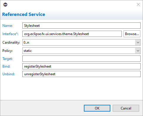

Well you said that "System.out.println("Default Registration.");" is not printed which is perfectly fine because this method is only invoked if you have services of type "Stylesheet"
I created the two services, as mentioned by linking the two classes DayTheme and NightTheme to them, then under the "Services" tab I added a "Reference Services" of the "Stylesheet" type, whose characteristics are shown in the attached image.
The constructor in the DayTheme class is as follows:
public class DefaultTheme extends AbstractTheme {
	public DefaultTheme() {
	super("theme.default", "Default theme", DefaultTheme.class.getClassLoader().getResource("css/default.css"));
then has defined with three fields:
1) theme ID
2) theme name
3) url of the linked css
  • Attachment: Image 3.png
    (Size: 9.10KB, Downloaded 170 times)
Re: CSS problem on JavaFX e4 app [message #1823841 is a reply to message #1823796] Thu, 02 April 2020 16:24 Go to previous messageGo to next message
But that's wrong you have to pass Day.css instead of default.css, and for the other theme it has to be Night.css. I can only repeat look at the sources and how the themes are defined there
