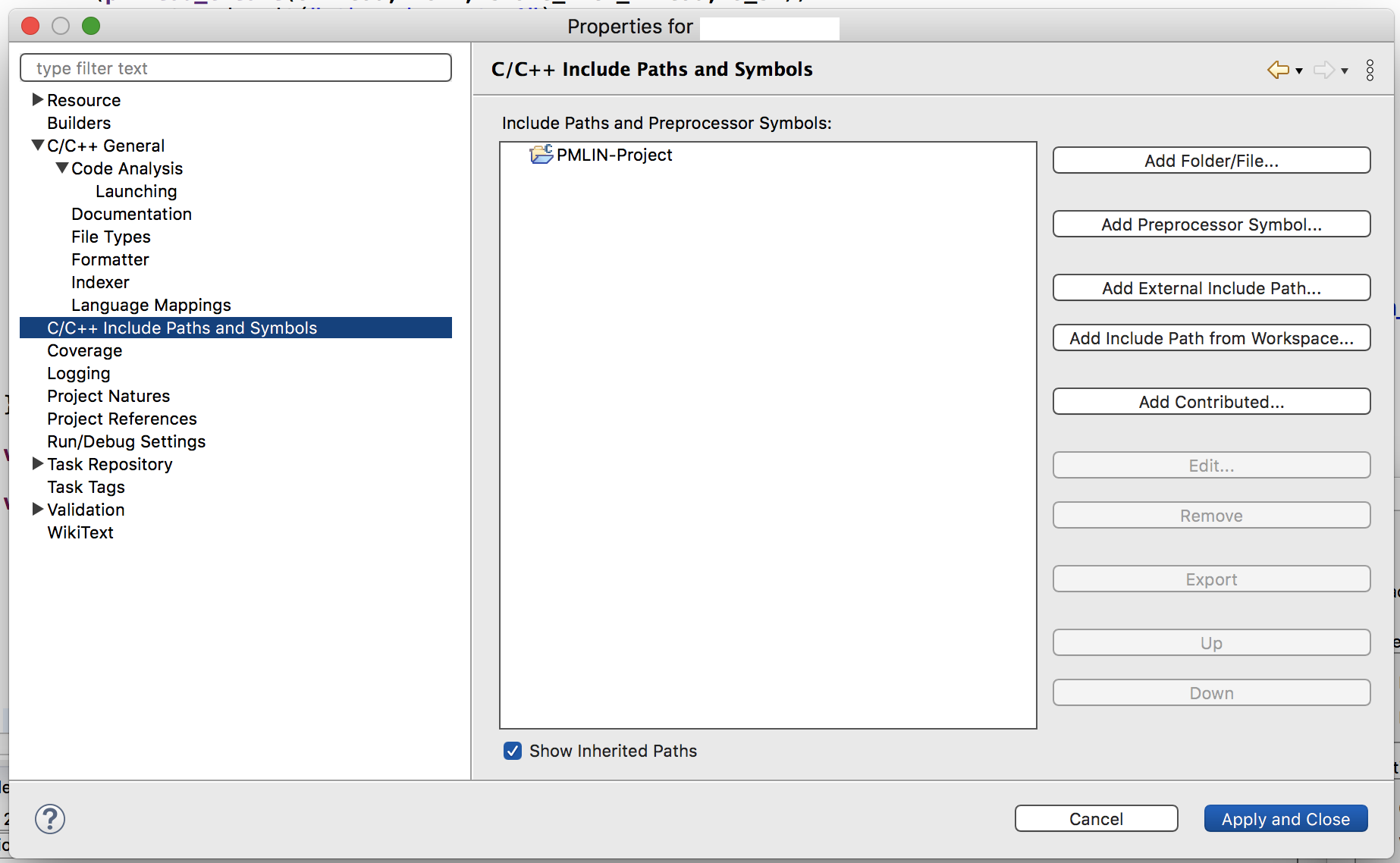

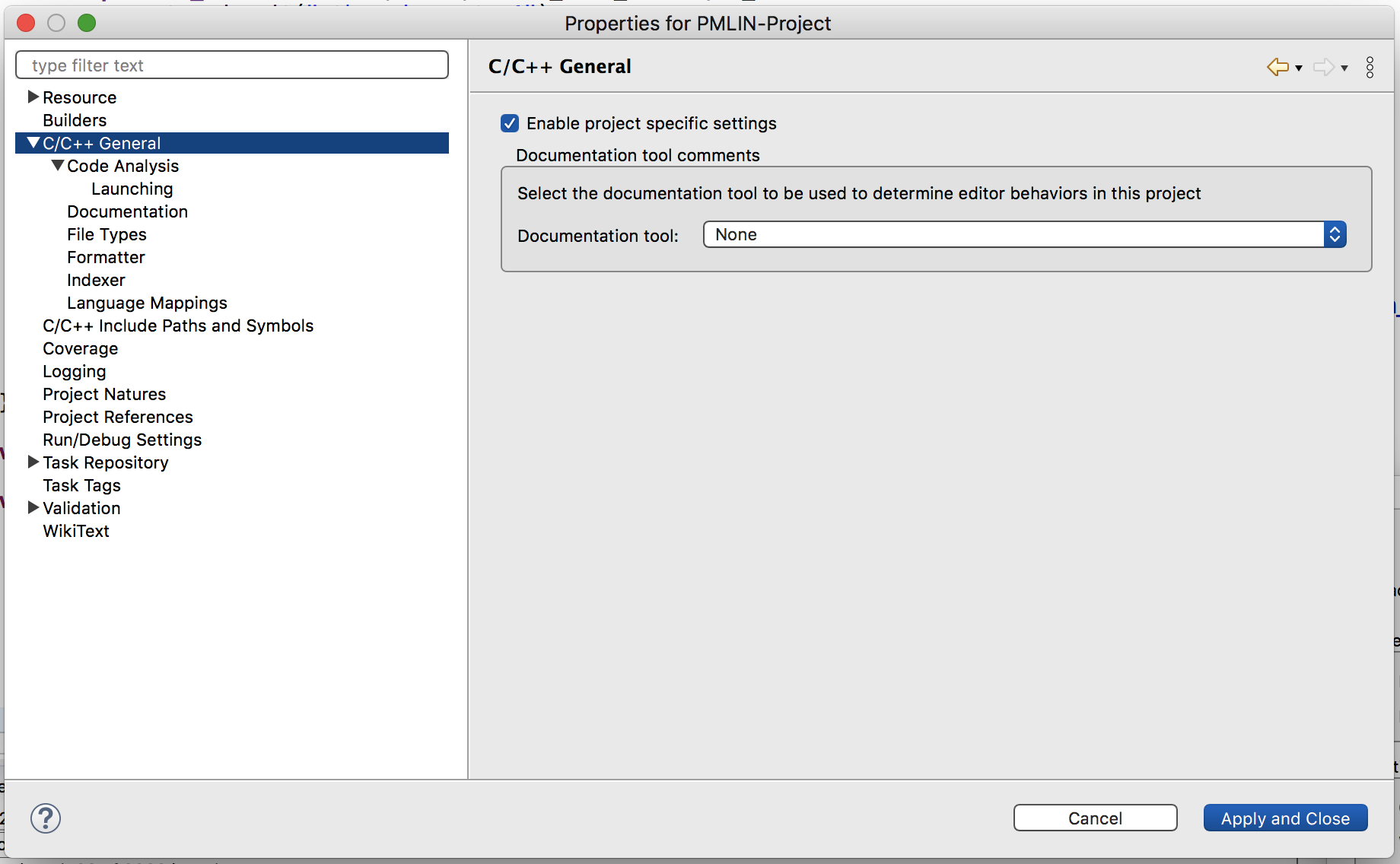

Sorry, I must be dence, I cannot find it (Preprocessor Include Paths, Macros etc.)
index.php/fa/37598/0/
index.php/fa/37597/0/

Looks like you are using a plugin that's a modified CDT.
This is what the standard CDT looks like:
index.php/fa/37599/0/
Maybe you can set the language macro with C/C++ Include Paths and Symbols
but I can't be sure since I don't have the plugin.

Thanks, the pic does not show but I don't think that matters.
The interesting thing is that I today loaded the plugin so I would have expected it to be standard and up to date.
I will investigate my plugins situation.
Thanks once more.
