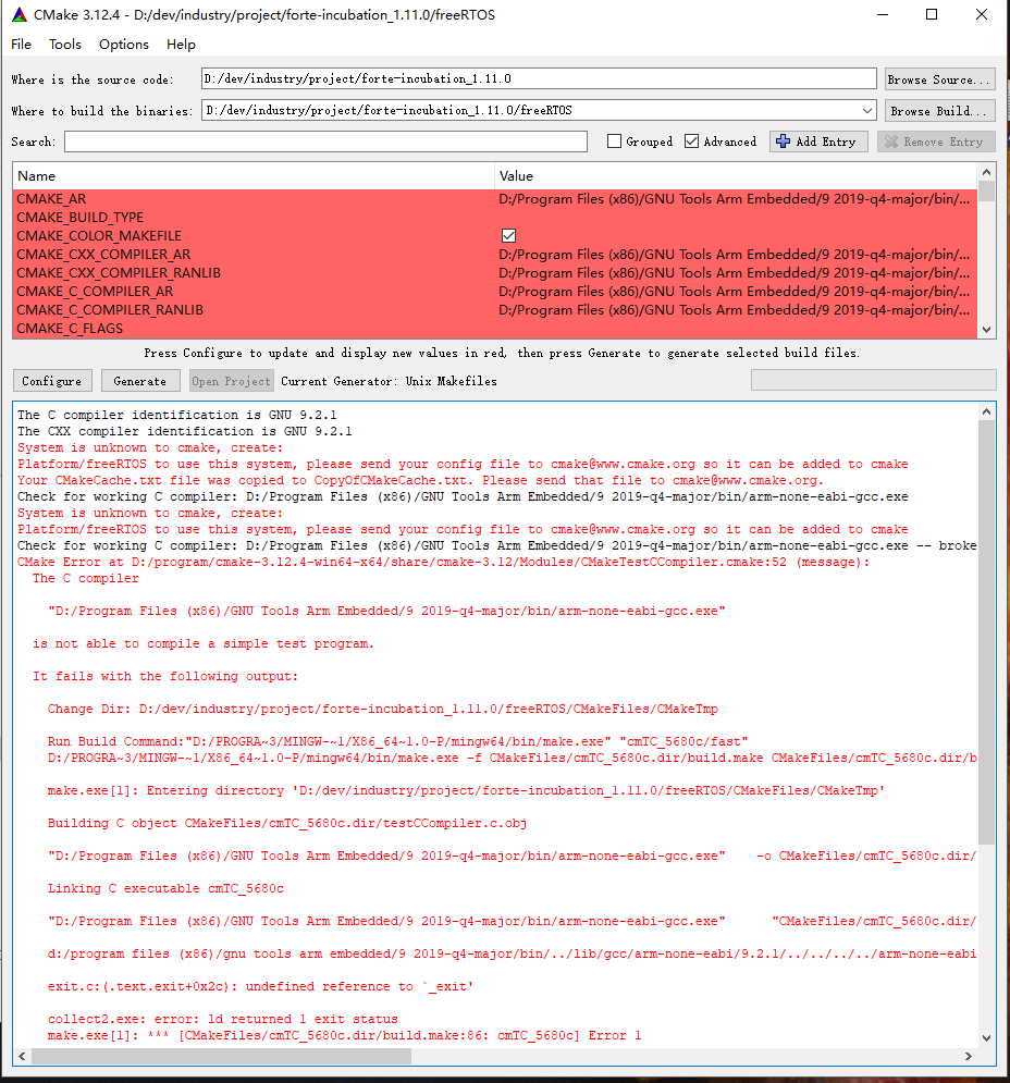

Re: Cmake with freertos [message #1822873 is a reply to message #1822870] Mon, 16 March 2020 05:21 Go to previous messageGo to next message
Can you pleaes a printscreen of your Cmake configuration you're using.
Try running CMake as administrator
Re: Cmake with freertos [message #1822875 is a reply to message #1822873] Mon, 16 March 2020 05:44 Go to previous messageGo to next message
The snapshots
  • Attachment: snap2.jpg
    (Size: 70.59KB, Downloaded 170 times)
  • Attachment: snap1.jpg
    (Size: 147.41KB, Downloaded 166 times)
