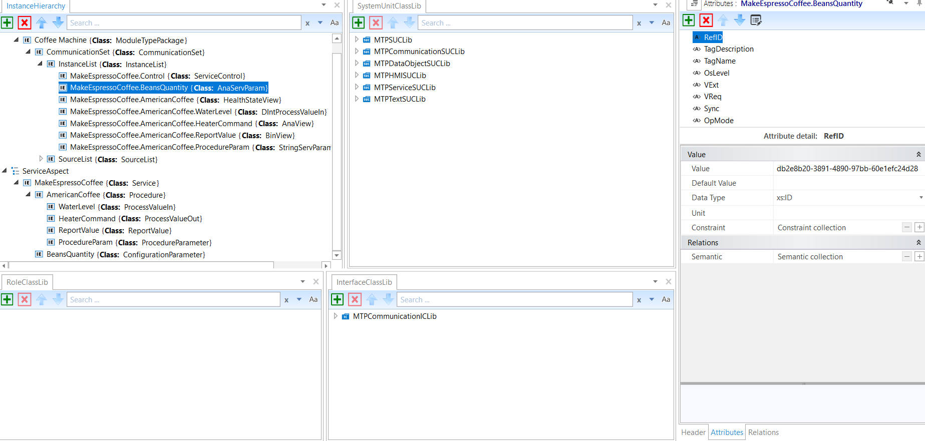

Thanks for your reply. Purpose is to automatically generate ID's on run-time using GUID. Please see attached screenshot. This application was generated using XML code in Acceleo. Next thing what i am looking to
implement is GUID. From the image. Water level under American coffee is referring to water level under instance list. In order to do implementation, i need to write java code which implements GUID. Is it possible to
use header files of Java and write Java code for GUID and connect somehow with XML to achieve the purpose?

OK. It seems like your use of XML and ID in the same paragraph confused me. You are not interested in xmi:id at all, but an ordinary model attribute that has a GUID value.
It is fairly easy to specify a custom EDataType that auto-allocates unique values using the EcoreUtil.generateUUID().
Once you have implemented it, you can then start to tackle the following bugs that are probably due to a lack of consideration of what you actually want to achieve.
- when you reload the model different UUIDs are allocated
- when you cut and paste in the editor, duplicate UUIDs appear
- when you change an ancestor, the UUID is not changed
- when you change an ancestor and then change it back again the UUID remains changed
I think I might be inclined to maintain a load-time GUID-to-EObject map, a think-of-a-new-GUID cell editor action, and a validation that each actual GUID is consistent with load-time and subsequently created elements.
