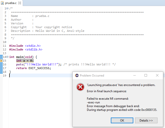

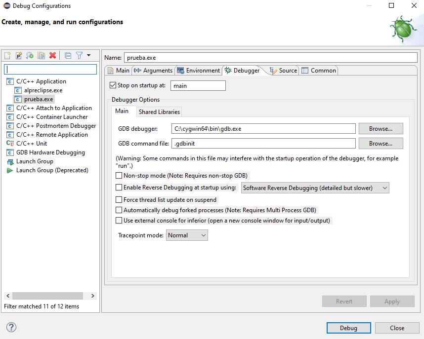

Hello, in the first place thanks in advance...
Today I using eclipse for the first time, compile well an execute well, but when I click on debug the ide launch a message with: Failed to execute MI command: -exec-run
This is my version of ide:
Version: 2019-12 (4.14.0)
Build id: 20191212-1212
Any idea?

Re: Failed to execute MI command: -exec-run [message #1822634 is a reply to message #1822556] Tue, 10 March 2020 11:48 Go to previous messageGo to next message
Error code: 0xc0000135 is caused by a missing DLL.
https://answers.microsoft.com/en-us/windows/forum/all/error-code-0xc0000135/2f20f9c4-594e-4464-9862-69926be45218
You can try running Dependency Walker to find out which but it's likely cygwin.dll
http://www.dependencywalker.com/
You might not have everything installed.
or may simply need to adjust the DLL search order
https://docs.microsoft.com/en-us/windows/win32/dlls/dynamic-link-library-search-order
