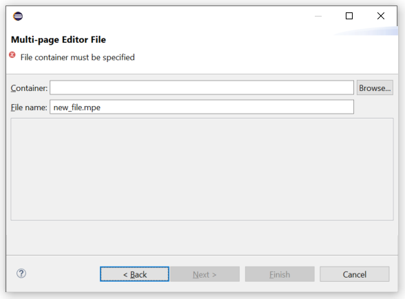

Hello, my goal was to have a wizard that creates my dsl file. In the wizard i would have an xtext editor embedded and certain lists of function which the user would be able to add inside the editor. I have followed tutorials and examples found on the forum, github and a tutorial from XtextCon, I have used a synthetic resource and i am not using the @Inject-ed resourceProvider and embedded editorFactory as they were both nulls at runtime, instead i initialized them myself, everything looks fine during debug, but the editor is not appear in the page, and i don't know why. Maybe it's also worth mentioning that the editor would not be based directly inside the parent composite, as i have other swt widgets inside the wizard page and the xtextEditorComposite is part of the parent composite. Here is the code for the editor:

Thanks for the response, i've used the "new file wizard" template at the creation of the plugin and i've named my wizard "SWT Embedded Xtext Editor". I've added the previous code to the wizard page and the goal was to see the xtext editor in the page.

You have to set the layout of the xtextEditorComposite as well:
xtextEditorComposite.setLayout(new GridLayout());
Re: Xtext Embedded editor not shown in wizard [message #1822569 is a reply to message #1822546] Tue, 10 March 2020 04:14 Go to previous message
Thank you, it worked :)
