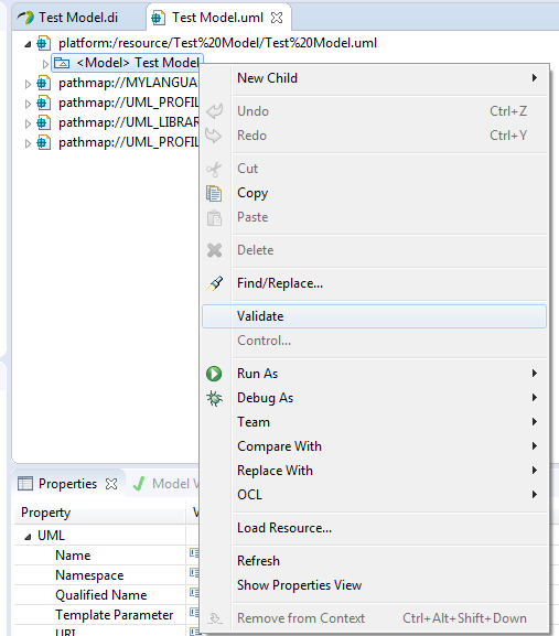

update:
When I run the validation on the uml model, as shown below, the validation rule I've defined is run:
index.php/fa/37484/0/

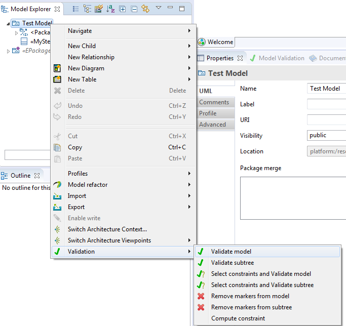

However, when I run the validation from the contextual from papyrus, then the rule is not run:
index.php/fa/37485/0/
What should I do to have the validation applied in the second case?

Raise a Bugzilla. It has certainly been raised and fixed at least once in conjunction with OCL embedded in UML in Papyrus. The problem is that the neither the EValidator framework not UML is not properly extensible requiring lowrr applications to carefully re-implement a multi-evel validation. It looks as if Papyrus has insufficient test coverage to avoid backsliding on the fixes. Within Papyrus you might try the OCL->Validate option.
