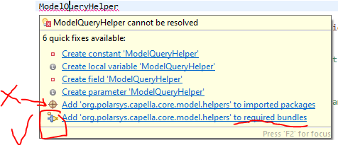

I could solve the problem. Actually, the NoClassDefFoundError is a run time error. I used to add the TranscationHelper class to the imported packages using the eclipse suggestions instead of adding it to the required bundles. The attached picture shows that.index.php/fa/37567/0/
When I used to add the missing classes to the imported packages, it solves the compilation errors but during the run time the JVM doesn't find them so it throws the NoDefClassError.
