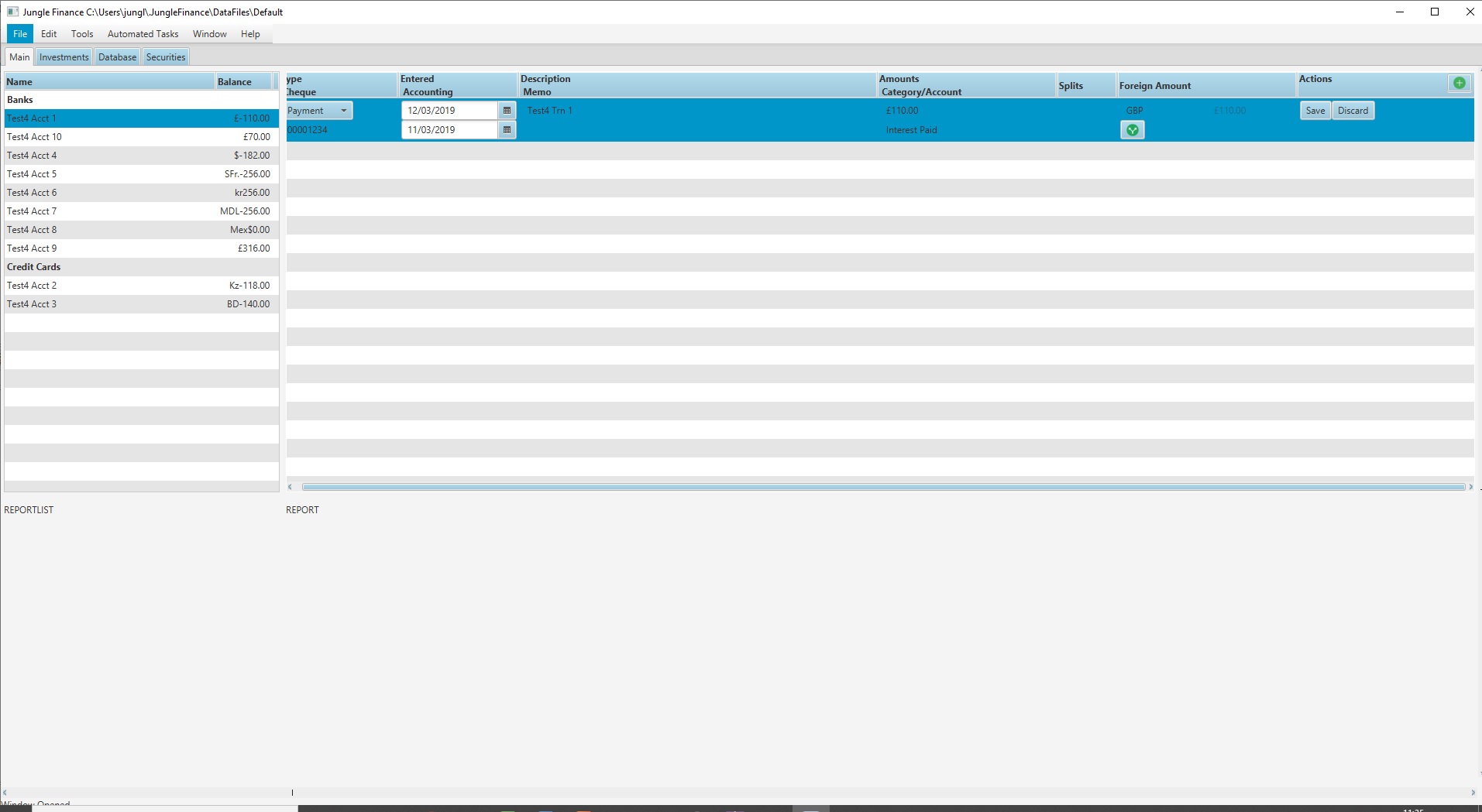

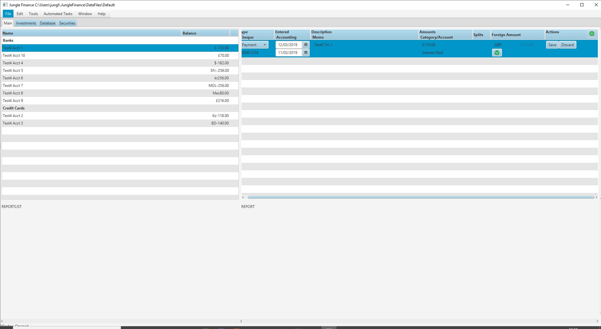

I have a javafx app that has four screens within one window. The user can move the split to give more space to one screen. In one screen the user can edit a transaction with a 'Save' and a 'Discard' button.
If the screens are set so the transaction screen is small Jubula does not find the 'Save' Button (see screen1.jpg) and I receive a Component Not Found Error.
If the screens are set so the transaction screen is larger Jubula finds the 'Save' button (see screen2.jpg) and the test is successful.

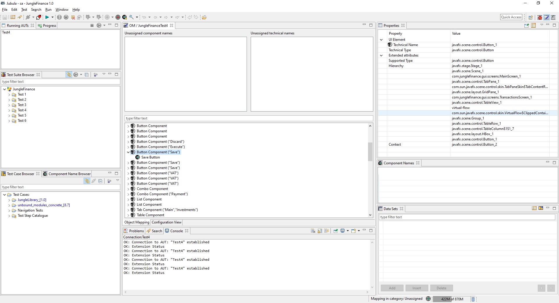

I have also included the details of the technical component (see savebtntechcomponent.jpg) for the button.

Components in Tables are not really supported by default. You can only click them via the normal table action (with the definition where you should click ). Jubula can sadly not guarantee to find the Buttons in Tables or other complex structures.
I see two option for this:
1. Use the table action select entry in component with the specification of the position
2. write an extension to supoort your specific case (this is more work)
