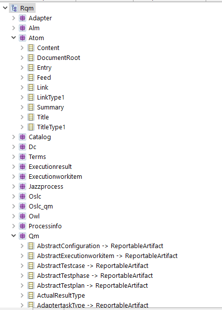

I'm using the IBM RQM's webservice for creating Test cases from my application. While sending the data to the server, it follows feed.xsd and qm.xsd. We have created the ECORE model from these XSDs and we have populated various model data from the application. Now, I have to serialize the EMF model to an XML file before sending across to the web service server. I have attached the schemas along with this post.
When I save the EMF model, I see that all the namespaces are saved to the root element (that is feed element)

Attached the ECORE model overview as picture.
