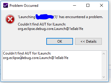

Couldn't find AUT for ILaunch: org.eclipse.debug.core.Launch@1e8ab1fe [message #1821788] Thu, 20 February 2020 02:33 Go to next message
Every now and then an AUT launch get broken.
RCPTT IDE 2.4.3.
index.php/fa/37408/0/
  • Attachment: Capture.PNG
    (Size: 12.23KB, Downloaded 679 times)
Re: Couldn't find AUT for ILaunch: org.eclipse.debug.core.Launch@1e8ab1fe [message #1831032 is a reply to message #1821788] Mon, 10 August 2020 05:12 Go to previous messageGo to next message
We found a workaround for this (don't ask how...) for this:
  1. Go to your rcptt\workspace\.metadata\.plugins\org.eclipse.debug.core\.launches folder of your RCPTT Installation
  2. Open your <Application>.launch file. (<Application> is the name of your Application in Application View)
  3. Remove the strange line regarding the launch ID (e.g. <stringAttribute key="org.eclipse.rcptt.launching.ATTR_AUT_LAUNCH_ID" value="ea879584-ab1b-479a-90cb-0dcf7c0c52d1"/>)
  4. Restart your RCPTT Application
  5. After restart, AUT can be started again
