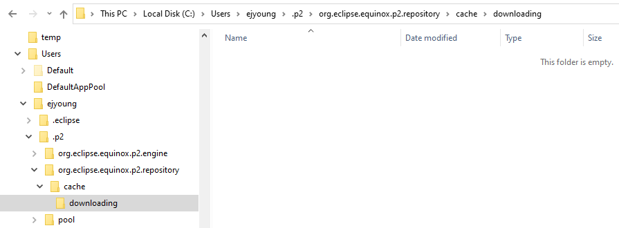

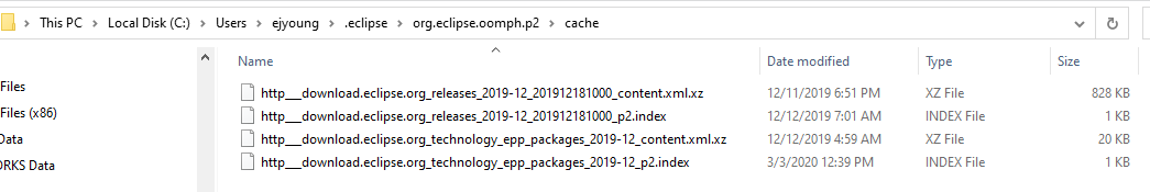

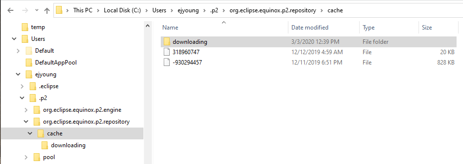

One thing you could try is to remove the folders <home>\.p2\org.eclipse.equinox.p2.repository\cache (p2's partial cache with cryptic names) and <home>\.eclipse\org.eclipse.oomph.p2\cache (Oomph's full cache with names that indicate from which site the file was actually loaded). If you then try again, it will be interesting to know which cached results successfully show up in Oomph's cache (to know how far it got in the loading process). Also, is the folder \.p2\org.eclipse.equinox.p2.repository\cache\download's empty after a retry (did any downloads attempts fail to be moved to the actual cache folder)?

I did all of the steps you listed and attached screenshots of the results.
Thanks for your help.

It seems clear from the cache state that nothing could be loaded from the Oomph repo. But http://download.eclipse.org/oomph/updates/milestone/latest/compositeContent.jar most definitely exists and should have been tried and that should have been successful. I can only account for this failure if the firewall is somehow configured differently on the two failing machines. On those machines does the URL http://download.eclipse.org/oomph/updates/milestone/latest/compositeContent.jar work in a browser?
