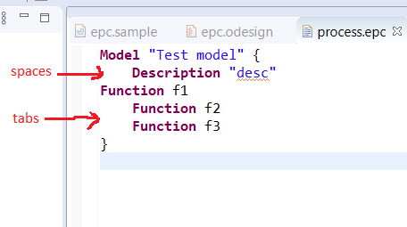

It seems after setting "Preferences -> General -> Editors -> Text Editors -> Insert spaces for tabs" Xtext uses spaces for indentation.
However when I add elements to a model using an external editor (Eclipse Sirius). Please see an attached screenshot. The first element is added without indentation (f1), the rest added elements are intented with tabs.
Here is a grammar fragment:
Model returns Model: {Model}
    'Model' name=EString
        ('Version' version=EString)?
        ('Description' description=EString)?
        elements+=ModelElement*

Re: Spaces for indentation [message #1821465 is a reply to message #1821463] Thu, 13 February 2020 07:40 Go to previous messageGo to next message
hi,
is your formatter called at all?
did you debug what is uses?
besides that you needs to have a look what edits are produced any why.
unfortunately the code is hard to understand and has a notable number of bugs.
[Updated on: Thu, 13 February 2020 07:43] by Moderator
Re: Spaces for indentation [message #1821468 is a reply to message #1821465] Thu, 13 February 2020 08:04 Go to previous messageGo to next message
Yes, formatter is called. When I select all text in a text buffer and press Ctrl-Shift-F the code is formatted as expected.
Can you tell me what bugs the code has? I didn't found a documentation on AbstractFormatter2 , just a several examples. So formatting is a black-box for me.
Here is a full project: https://github.com/AresEkb/epc
Re: Spaces for indentation [message #1821473 is a reply to message #1821468] Thu, 13 February 2020 08:24 Go to previous messageGo to next message
sorry you might find some at xtext-core. you have to debug yourself to see what happens there
Re: Spaces for indentation [message #1821474 is a reply to message #1821473] Thu, 13 February 2020 08:46 Go to previous messageGo to next message
Thanks for help! I've found several small examples here https://github.com/eclipse/xtext-core/tree/master/org.eclipse.xtext.testlanguages
I think that the formatting API is very cryptic. And the documentation or a big sample for a complex language with several use cases (like nested indentation, etc.) is really required. I understand that resources are limited and this is not a priority.
Thanks for direction, I will debug it.
Re: Spaces for indentation [message #1821501 is a reply to message #1821474] Thu, 13 February 2020 11:55 Go to previous messageGo to next message
For the documentation of the new formatting API please refer to the following slide share:
https://de.slideshare.net/mobile/meysholdt/xtexts-new-formatter-api
Re: Spaces for indentation [message #1821502 is a reply to message #1821501] Thu, 13 February 2020 11:58 Go to previous messageGo to next message
Re: Spaces for indentation [message #1822244 is a reply to message #1821502] Mon, 02 March 2020 07:27 Go to previous message
In case someone winds up on this thread while doing a search on the subject, a practical solution is also documented in this other thread: https://www.eclipse.org/forums/index.php/t/1102362/
I had the same issue that I could not get the formatter to follow my preferences on the initial programmatic generation of my model. A subsequent format request would fix it, but the initial format job always used tabs. When used in command line mode, it was hopeless to get spaces because the user was not interacting and could not perform a interactive manual correction.
There must be a proper fix lurking somewhere, or a bug lurking somewhere, but the thread linked above has information on how to hard code the indentation to spaces which worked for my uses.
Also, FWIW, whitespace languages see multiple spaces and tabs as different block indentations, so it was a real headache for my DSL because the user starts getting errors and can't tell why unless they display whitespace and know exactly what's going on.
