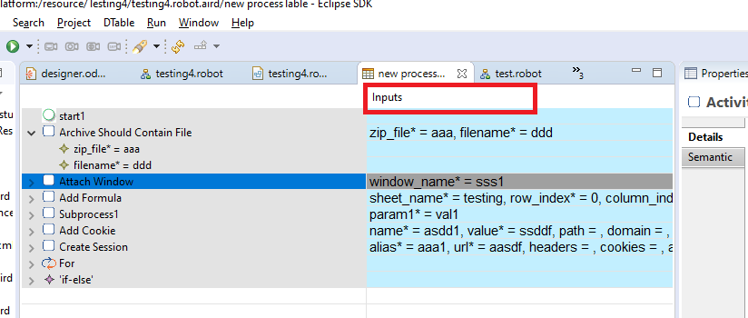

i am trying to create table representation for my project, i am facing 2 issue to provide a better look:
1. i am unable to change font/ color and remove icon for 1st column that is header column in which it contains my model. it is showing one icon and grey color and font size is fix. {Please refer :Attachment-1}

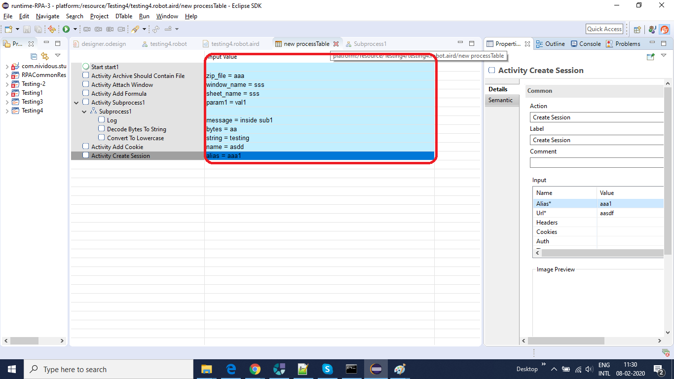

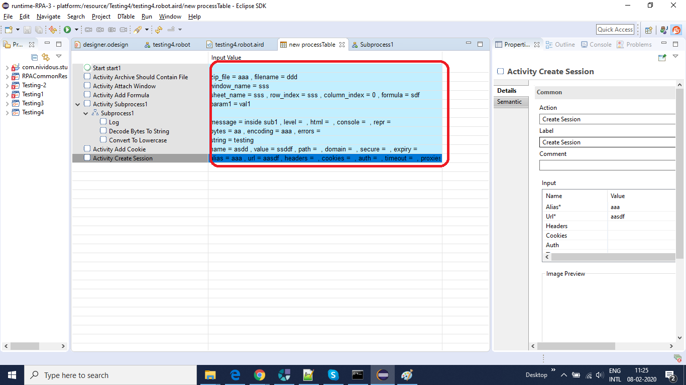

2. i am unable to insert new line for label expression in my column (Input Value) . {Please refer :Attachment-2}, i want every input which i have currently separated with column should be placed in different row {line}, but if i am trying to separate with new line, only first line is visible. {Please refer :Attachment-3}

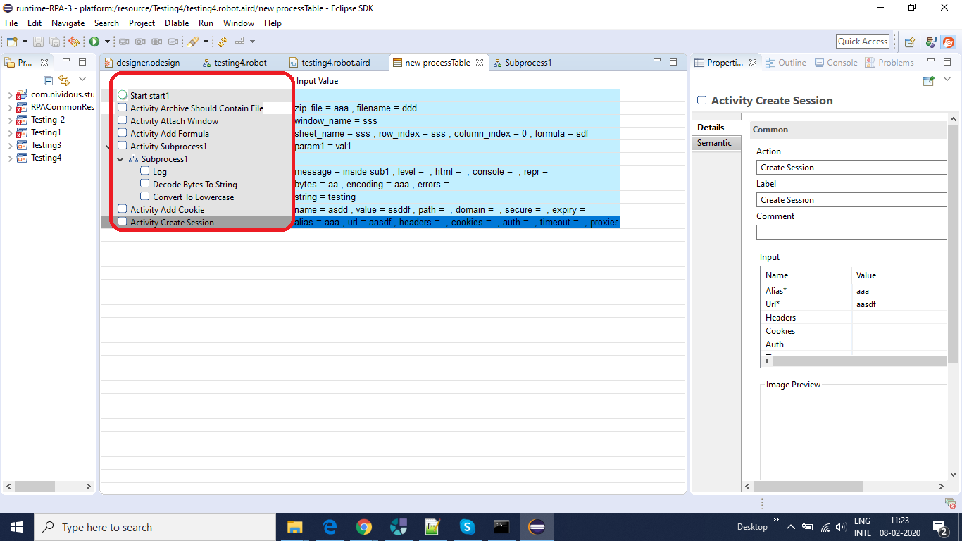

3. How can i change font of column title. {Please refer :Attachment-4}

1- Indeed, this is a limitation of the headers, it only displays what the content provider gather from your metamodel .edit plugin: the icon and the label. I don't think that we have an extension point or API allowing you to change it easily programmatically, this would require some work on the table editor directly.
2- I am not sure that I understood what you meant. A line mapping, will display each semantic element that was collected from the semantic candidate expression so inserting a new line will require to add a new element. Don't you need more columns here to display each "input value" in its appropriate column. Based on the properties view in the column, you can display columns for "alias", "headers", "url", "cookies"...
3- Unfortunately, we have the same limitation for column headers as for line headers, you can't change it from the specification model (odesign) and we have no extension point for it. It would require an evolution (or a fork) of the editor.
