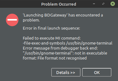

However, the same configuration does not work for debugging. I'm seeing the following message when launching the debugger:
index.php/fa/37295/0/
So far I've been unable to run the Eclipse debugger alongside the gnome terminal. Running the debugger within Eclipse doesn't work either, since i'm seeing the "Error opening terminal: unknown." message, after which the application is terminated. The "Attach to Application" option doesn't seem to work either, I'm only seeing "failure to attach to process" errors when trying to attach the debugger to the application running in a separate terminal (launched separately from the terminal).

Please do not start multiple threads for the same issue.
Edit the initial post instead.
Eclispe Run is like typing the command in a terminal (more or less).
The message you got is from gbd.
It says that the command is not an executable.
Maybe it's a script.

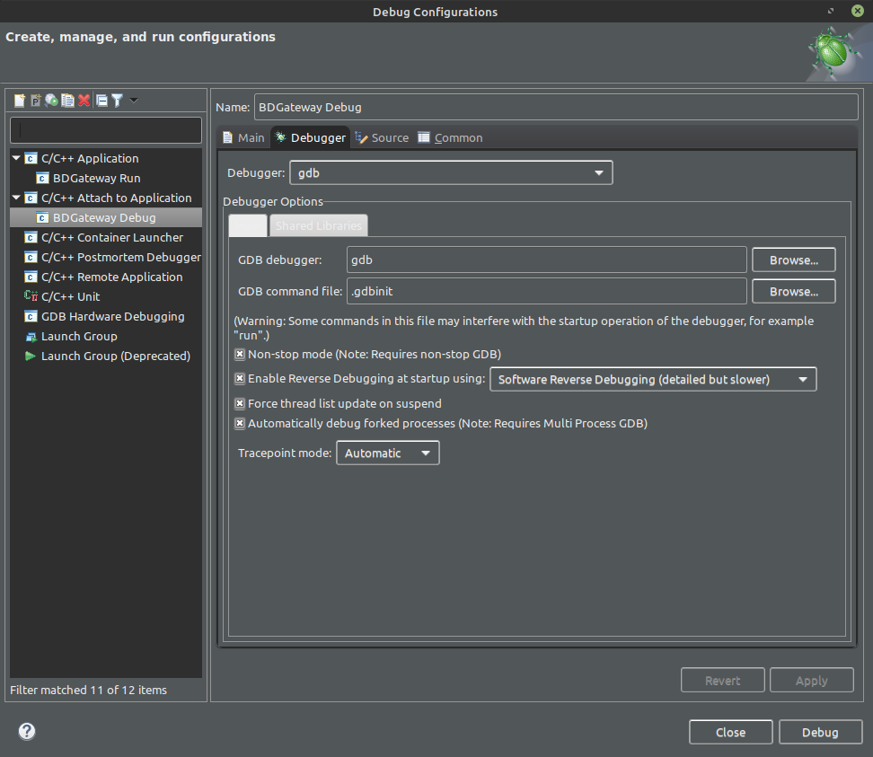

Re: Debugging ncurses application in Eclipse CDT (Linux) [message #1821794 is a reply to message #1821753] Thu, 20 February 2020 04:55 Go to previous message
Ok so I went into the Debug Configuration in Eclipse and selected all available options under the Debugger tab. Something worked, since I can finally debug my application by attaching to the running process! I'm not sure which setting it was exactly, here's my configuration:
index.php/fa/37409/0/
I also selected 'Automatic' in Tracepoint mode, and deselected the 'Allocate console' option under the Common tab.
I'm now able to set all breakpoints, see all running threads in the Debug tab, and access the Variables tab at any time.
