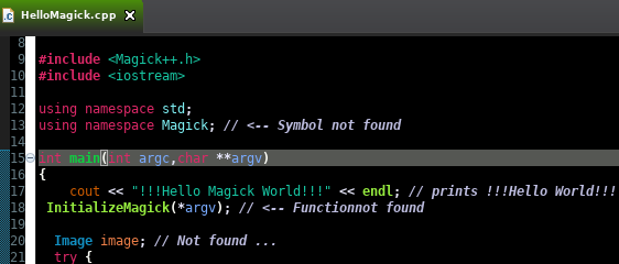

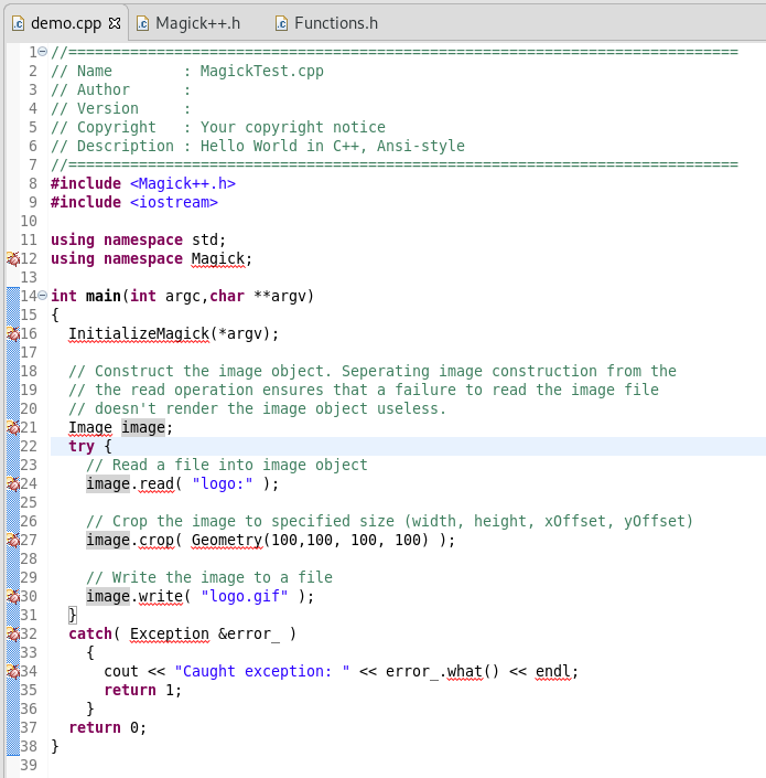

I'm trying to use Magick++ lib, code works as expcected but IDE does not
Issue:
IDE marks Symbol "Magick" could not be resolved
(Also other items from the same lib)
I can navigate to declaration of the lib header file, also it has no warning / error:
#include <Magick++.h>
And continue navigationg through all of it without issues or any warning on their files.
But on my cpp file, the lib Symbols are marked as errors.
Tryed to search about this kind of issues, but usually they are solved after adding the include to the header files witch is already done:
index.php/fa/37285/0/
Also tried to restart eclipse, reboot, refresh project.
The lib installation, compilation and run of sample demo works properly.
Sample:
index.php/fa/37286/0/

// Name        : MagickTest.cpp
// Author      :
// Version     :
// Copyright   : Your copyright notice
// Description : Hello World in C++, Ansi-style
#include <iostream>
using namespace std;
using namespace Magick; // <-- Symbol not found
int main(int argc,char **argv)
  InitializeMagick(*argv); // <-- Functionnot found
  Image image; // Not found ...
  try {
    // Read a file into image object
    image.read( "logo:" );
    // Crop the image to specified size (width, height, xOffset, yOffset)
    image.crop( Geometry(100,100, 100, 100) );
    // Write the image to a file
    image.write( "logo.gif" );
  catch( Exception &error_ )
      cout << "Caught exception: " << error_.what() << endl;
      return 1;
  return 0;

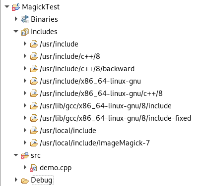

I copied your code and got no errors.
But I had to do at least one build.
index.php/fa/37360/0/
