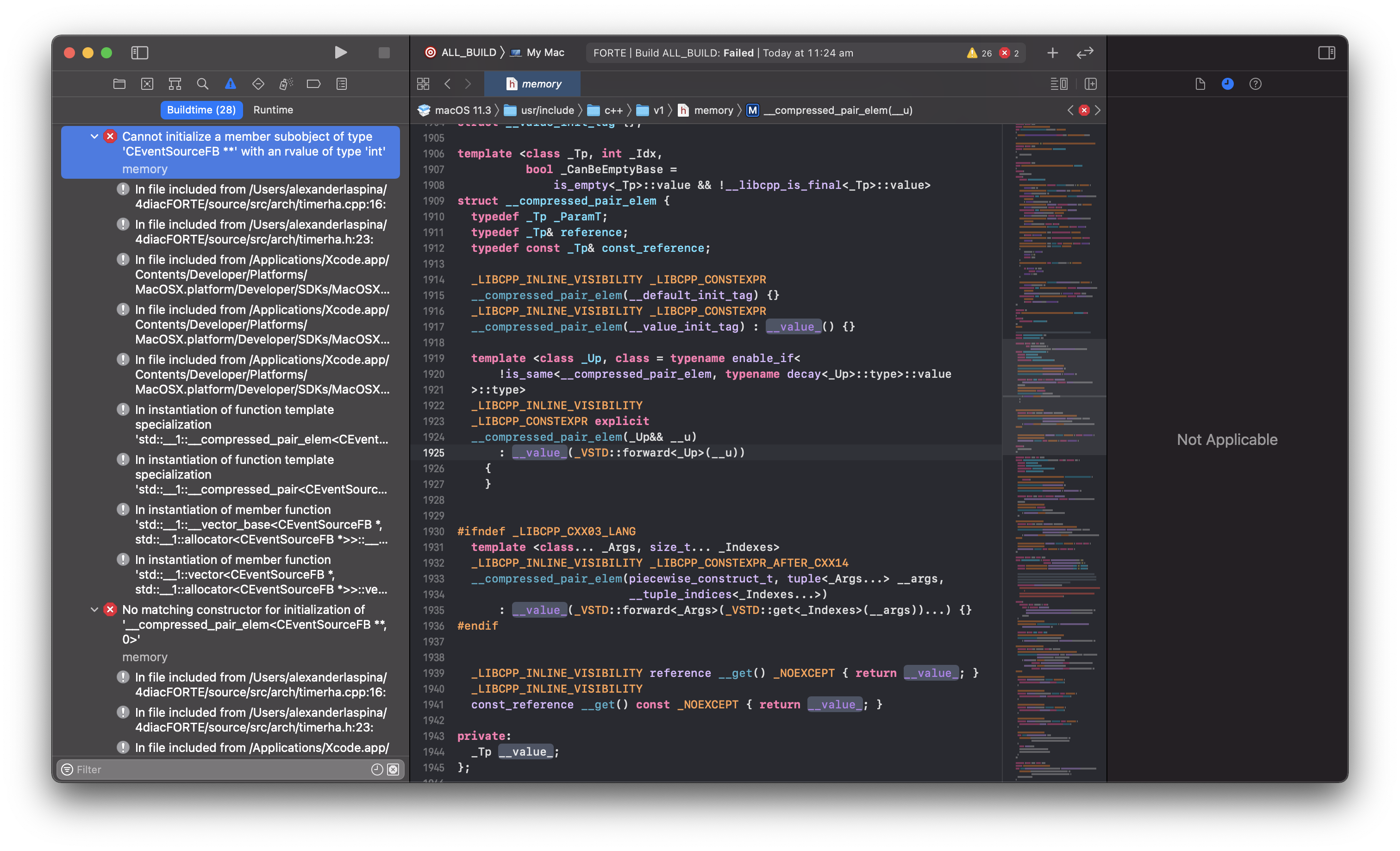

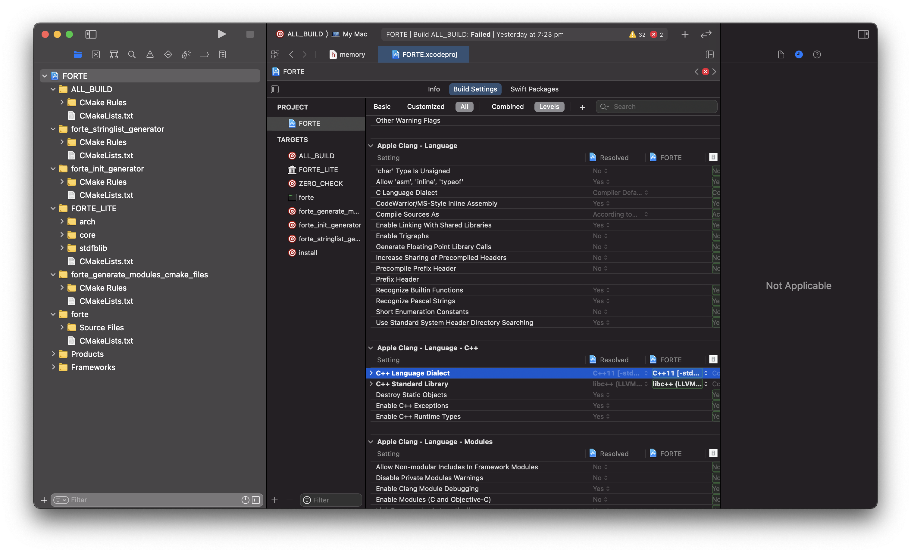

I have made the compiler flag changes to a clean Xcode 'forte 1.14.0' project to std++11 as recommended by Jose (screenshot pictured) and I was able to reproduce the 'CEventSourceFB **' with an rvalue of type 'long' error. The pthread issue is gone.
However using the latest org.eclipse.4diac.forte.git commit, I still have to manually change the compiler flags in Xcode, but on build a similar build error occurs but this time the datatype is 'int' instead of 'long' (screenshot pictured).

Jose added an advanced CMake configuration flag called FORTE_USE_STD_11. You need to turn this on to solve the mentioned issues.

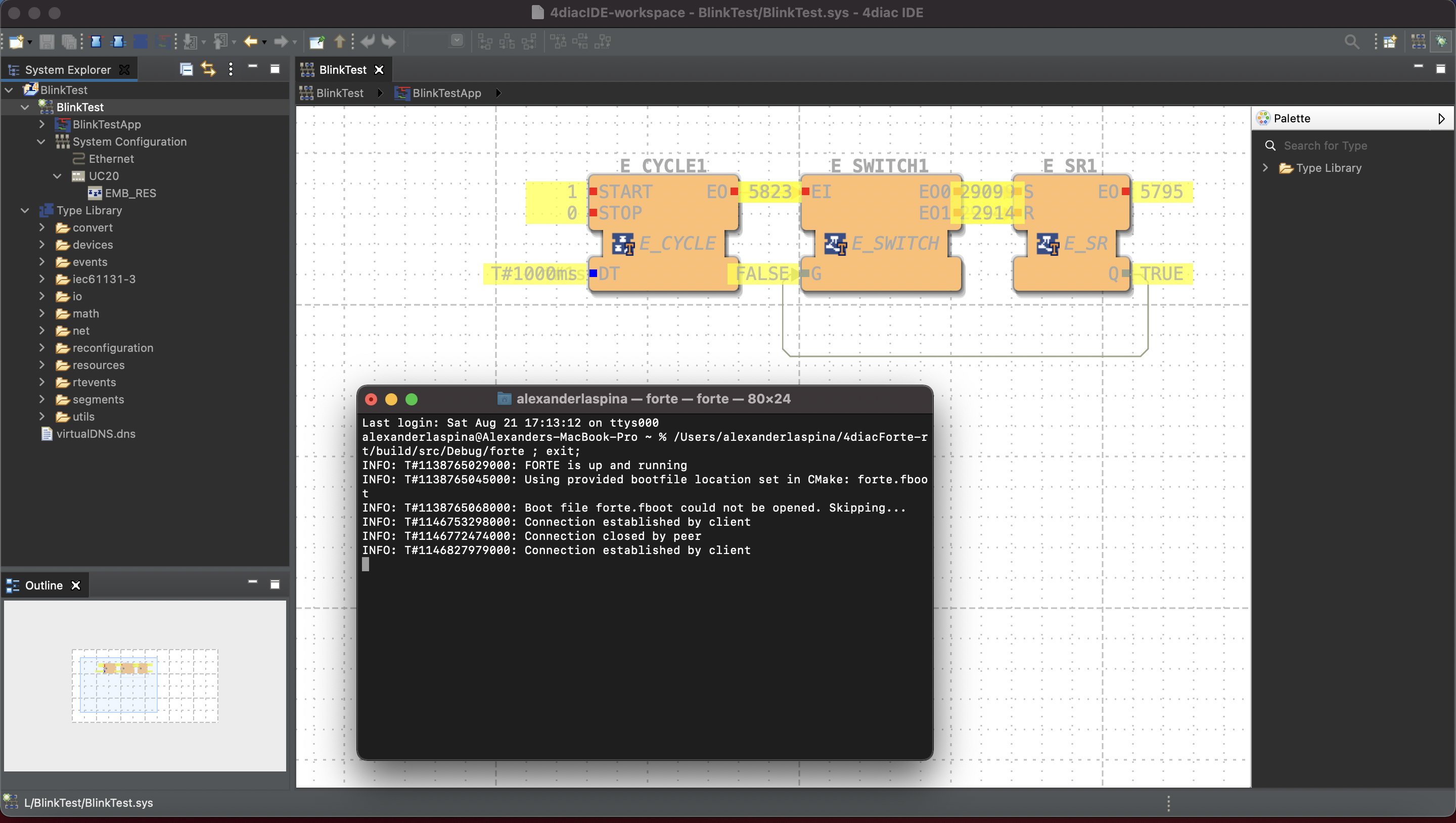

I have good news, I have been able to successfully compile Forte in Xcode on both macOS Mojave (Xcode 10.3 Intel X64) and macOS BigSur (Xcode 12.5.1 Apple M1 ARM64).

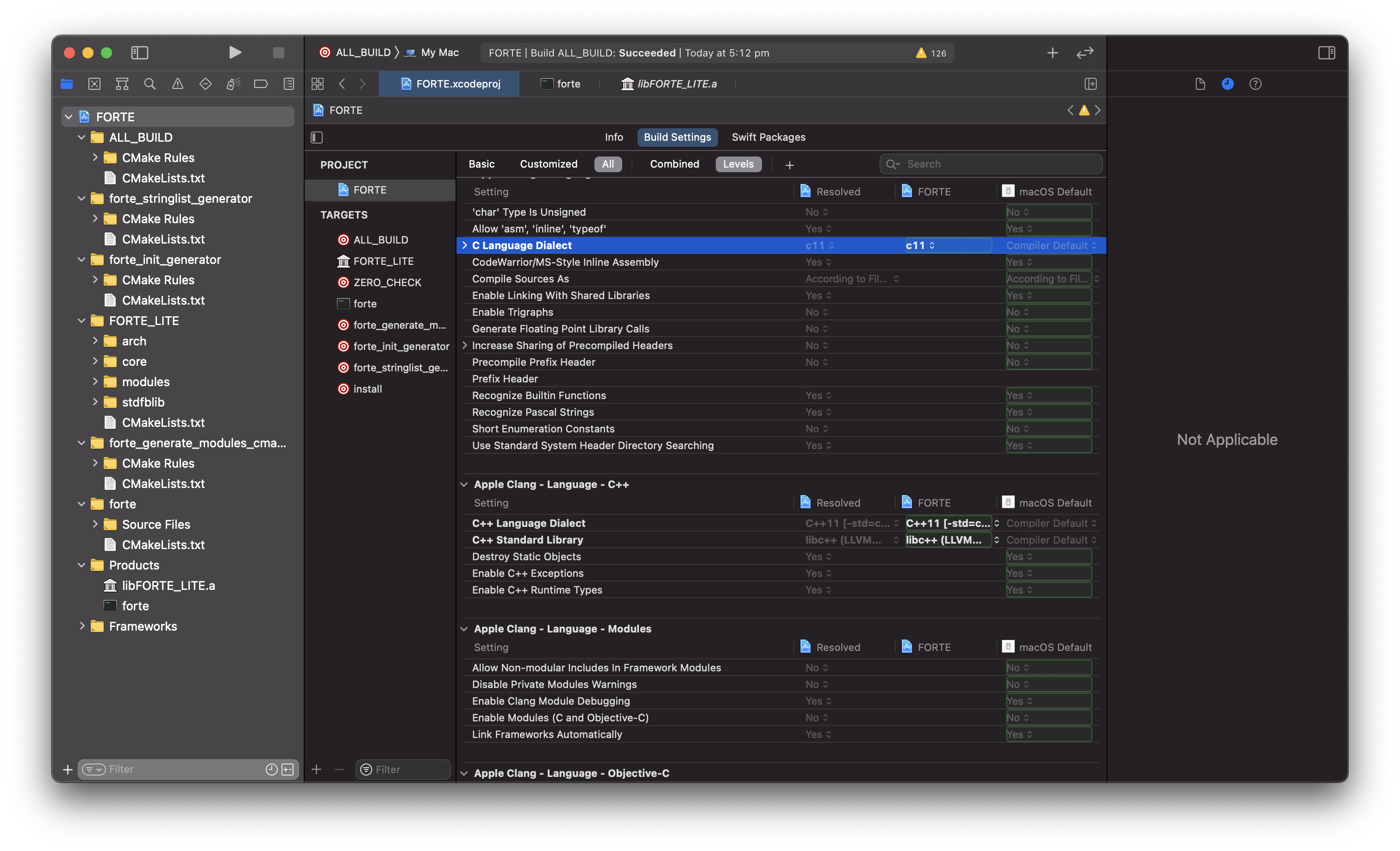

Xcode:
Double Click FORTE in the top of the Project Navigator and Select Build Settings. The following need to be changed from defaults:
Apple Clang - Language; C Language Dialect = C11
Apple Clang - Language - C++; C++ Language Dialect = C++[-std=c++11]
C++ Standard Library = libc++ (LLVM c++ standard library with c++11 support]
with ALL_BUILD > My Mac selected, select Build -> Build For -> Running.
the Forte executable will build and can be found in Products - forte
Some Screenshots attached.
