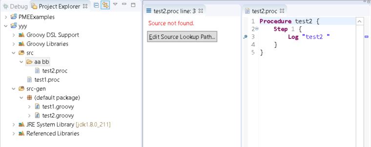

We have an Xtext DSL and code generator using the Tracing Code Generator as described in this blog:https://blogs.itemis.com/en/debugging-dsls-in-xtext-and-eclipse.
This normally works very well. The generated code together with a ._trace file is written to the src-gen folder by default and when executed will stop and display breakpoints in the DSL.
However, if there is a space in the workspace path then the DSL is not found when the breakpoint is hit.. The DSL source is not displayed and debugging is impossible. Could this be something to do with Xtext's interpretation of its ._trace file? Although binary the path name can be seen encoded as XML with %20 replacing any spaces. Could it be related to the EMF Resource URI encoding? The attached screenshot shows what happens.

Xtext generates the traceRegion for this example in org.eclipse.xtext.builder.updateTraceInformation:
line 423: AbstractTraceRegion traceRegion = ((ITraceRegionProvider) contents).getTraceRegion()
CompletableTraceRegion [myOffset=0, myLength=4385, useForDebugging=false] associations={
  LocationData [TextRegionWithLineInformation [0:51][lineNumber=0, endLineNumber=4]][path=aa%20bb/test2.proc]
} nestedRegions={
  CompletableTraceRegion [myOffset=3631, myLength=215, useForDebugging=true] associations={
    LocationData [TextRegionWithLineInformation [21:27][lineNumber=1, endLineNumber=3]][path=aa%20bb/test2.proc]
  } nestedRegions={
    CompletableTraceRegion [myOffset=3704, myLength=39, useForDebugging=true] associations={
      LocationData [TextRegionWithLineInformation [33:11][lineNumber=2, endLineNumber=2]][path=aa%20bb/test2.proc]
There is a '%20' in the relative path to the DSL instead of a space: [path=aa%20bb/test2.proc].
This comes from a call to the DefaultTraceURIConverter org.eclipse.xtext.generator.trace.getURIForTrace which returns aa%20bb/test2.proc.
I overrode this method and the problem went away. So we have a workaround (albeit with Discouraged access).
In my version of org.eclipse.xtext.generator.trace.DefaultTraceURIConverter::getURIForTrace(IProjectConfig projectConfig, AbsoluteURI absoluteURI).
I pre-process your absoluteURI using EMF's URI.decode
      AbsoluteURI decodedAbsoluteURI = new AbsoluteURI(URI.createURI(URI.decode(absoluteURI.getURI().toString())))
Is this a bug or is there a configuration I have missed?
