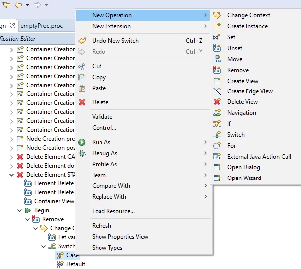

I was using Let to call a service and return a value to a variable and noticed that the option to inset the let as first operation of the case or default of a switch is missing from the context menu, is this intentional for some reason ?
I can create the Let later on and then drag it back to the correct place where it appears to work correctly, is this OK ?

It looks like a bug in the way the context menus are built in the UI, but should now have any impact at runtime if you find an alternate way. As a workaround you can also create a dummy "Change Context" operation with "var:self" (i.e. which does nothing), and then you should be able to create all operations inside of it.
I've opened https://bugs.eclipse.org/bugs/show_bug.cgi?id=559820 and a fix is incoming (https://git.eclipse.org/r/c/157129/) for the next maintenance version.
