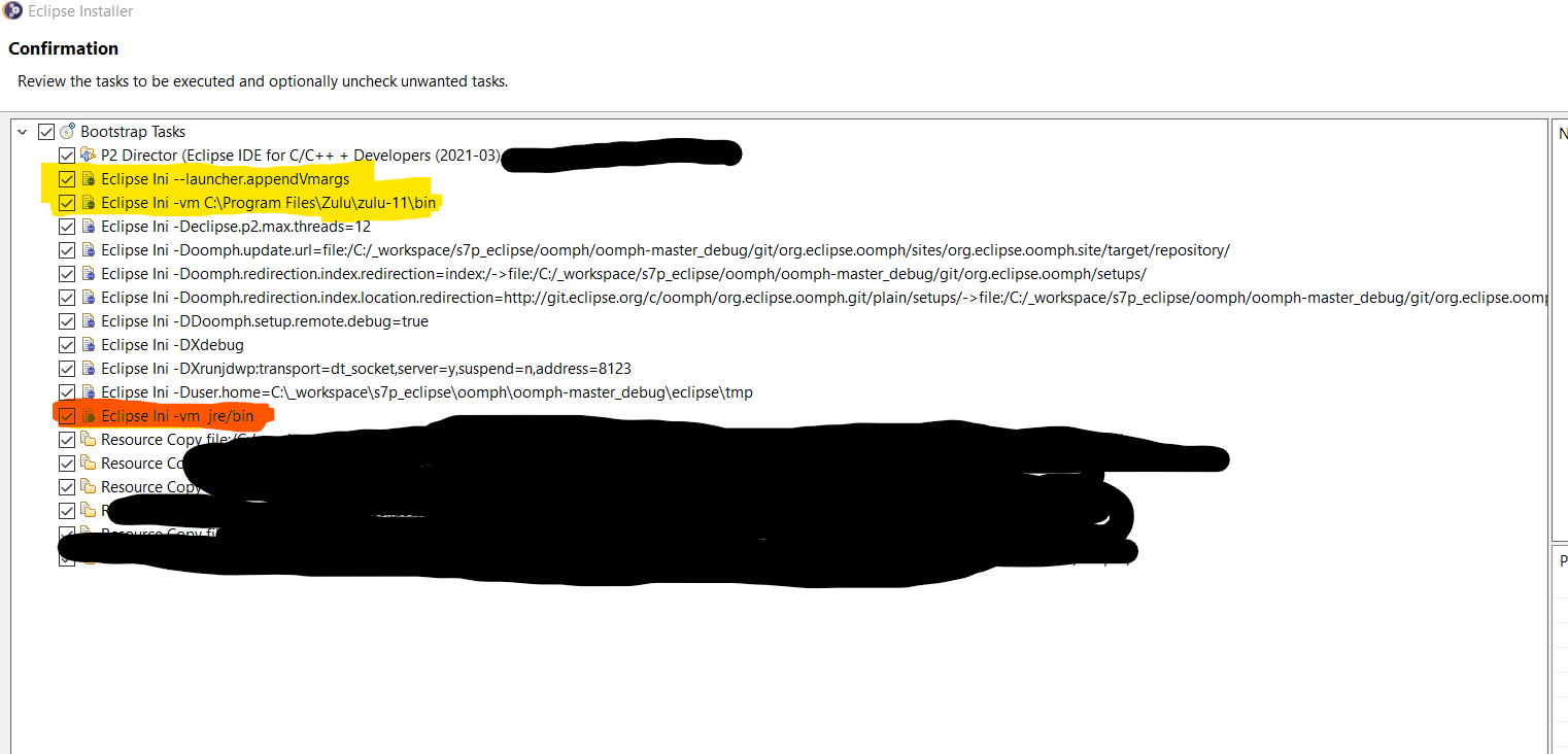

I am also trying to do bundled JRE and I would like to ask you how can I get rid off predefined -vm <java_path> in eclipse.ini.
I succesfully copied resources into eclipse install destination. I add -vm budled_java_path into Eclipse.ini.
But I do have predefined init task during setup which adds my localy installed java into Eclipse.ini.
See the attachted picture:
- yellow marked lines are somehome predefined and I do not know how to get rid of them
- red maked is my task which should be the only one there.
Re: Install eclipse with a bundled jre (jre copied inside eclipse installation) [message #1847911 is a reply to message #1847910] Fri, 12 November 2021 05:34 Go to previous messageGo to next message
Did you create the task exactly like this?
<setup:EclipseIniTask
    xmi:version="2.0"
    xmlns:setup="http://www.eclipse.org/oomph/setup/1.0"
    option="-vm"
    value="jre/bin"/>
It's important to separate the two parts into the option/value so that this -vm task overrides the other -vm task.
Re: Install eclipse with a bundled jre (jre copied inside eclipse installation) [message #1847912 is a reply to message #1847911] Fri, 12 November 2021 05:38 Go to previous messageGo to next message
Ed Merks wrote on Fri, 12 November 2021 10:34
    xmi:version="2.0"
    option="-vm"
    value="jre/bin"/>
I used the UI editor instead of XML. It looks like this in my .setup file:
<setupTask
          xsi:type="setup:EclipseIniTask"
          option="-vm "
          value="jre/bin"/>
Its hard to now the syntax without documentation :( But I will try it your way :)
Re: Install eclipse with a bundled jre (jre copied inside eclipse installation) [message #1847913 is a reply to message #1847912] Fri, 12 November 2021 06:49 Go to previous messageGo to next message
It worked perfectly! Thank you very much.
Re: Install eclipse with a bundled jre (jre copied inside eclipse installation) [message #1847914 is a reply to message #1847913] Fri, 12 November 2021 07:04 Go to previous messageGo to next message
Note that in your original version you had a space after -vm whereas the correct version does not have that.
Re: Install eclipse with a bundled jre (jre copied inside eclipse installation) [message #1847915 is a reply to message #1847914] Fri, 12 November 2021 07:18 Go to previous messageGo to next message
Yes, I have noticed, thats what I changed. Thank you again :)

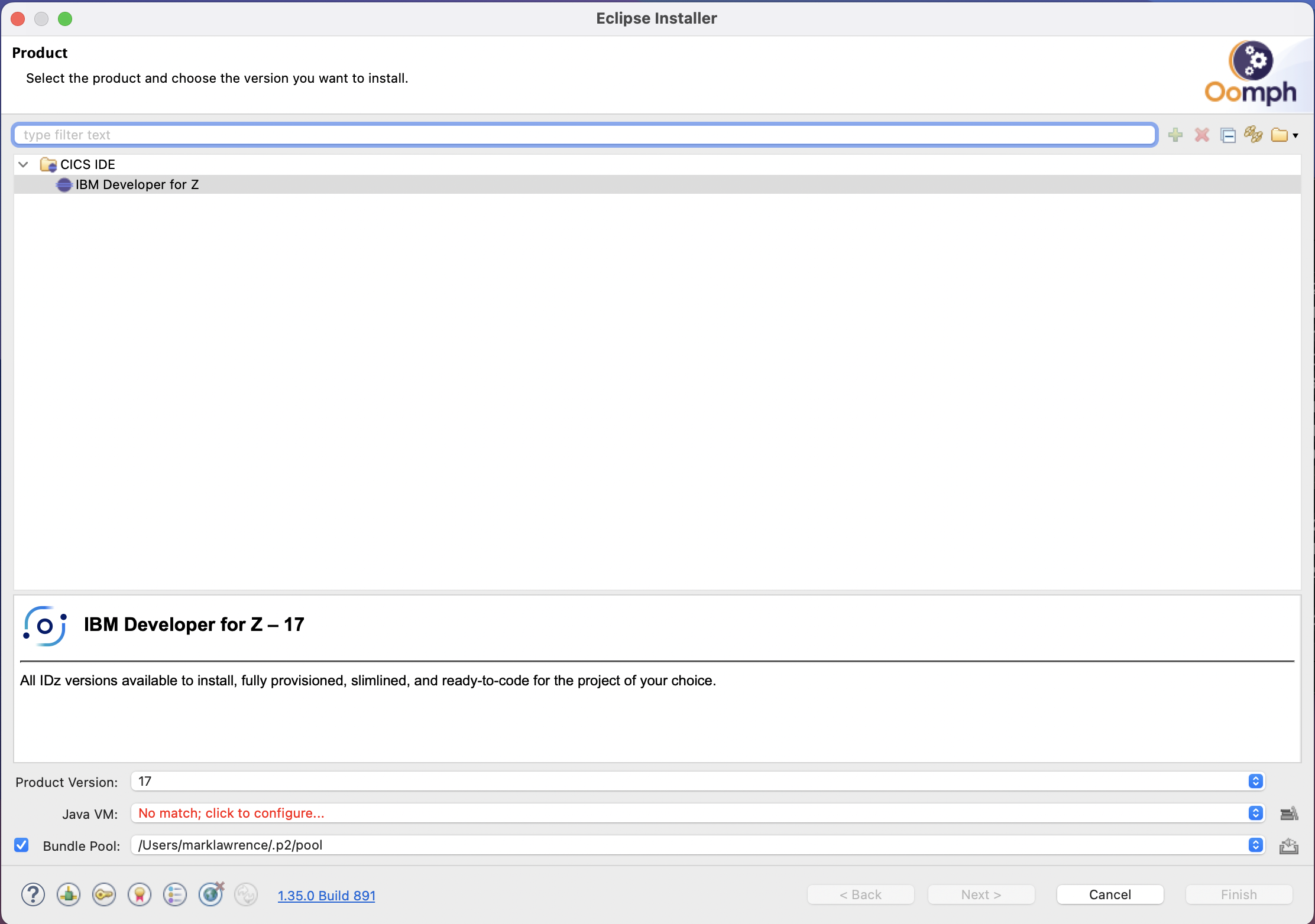

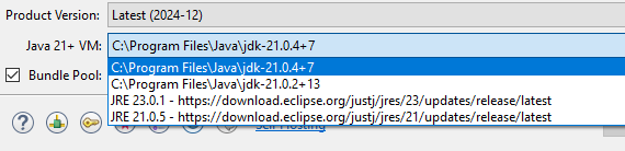

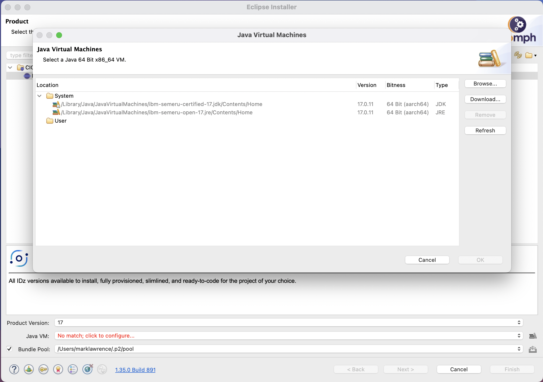

No, at the moment I see this:
index.php/fa/45369/0/
...and the Java's look like this:
index.php/fa/45372/0/
...the download button also doesn't do anything on my machine when clicked.
I think I'm happy about the JRE selection in the variables page. I think I've seen that if I make its path value something that's known, it doesn't appear on the variables page.

Yeah, sadly though we install the core plugin for 'IBM Developer for z/OS' along with its license, which doesn't support aarch64 (not even the latest 17.0.0 release last weekend), it goes BANG, so we just use rosetta2 and x86 everything on Mac Mx.

Re: Install eclipse with a bundled jre (jre copied inside eclipse installation) [message #1872231 is a reply to message #1872225] Fri, 25 October 2024 08:51 Go to previous messageGo to next message
Are you using your own index? The "standard" index has this annotation:
<base:Annotation
    xmi:version="2.0"
    xmlns:base="http://www.eclipse.org/oomph/base/1.0"
    source="http://www.eclipse.org/oomph/setup/JRE">
    <reference
        href="org.eclipse.jres.setup#/"/>
</base:Annotation>
That's used to load this resource:
https://github.com/eclipse-oomph/oomph/blob/master/setups/org.eclipse.jres.setup
And that's used to populate the drop-down combo box with p2 update site links to the JustJ JREs.
index.php/fa/45375/0/
That appears to be missing for you and that would normally help produce a valid selection that would allow the user to continue to the next page.

Ah, yes, we do use our own index, that would explain it.
I've given aarch64 a go, and it does work now with IDz 17, it didn't with 16, so I will start using aarch installer for Mac Mx now.
I think I've now hit a brick wall for the reason you gave earlier in the thread regarding using pre-packaged JREs. Resource Copy does now extract a zipped up JRE where I want, but the executable bits have been lost, so the JRE isn't runnable, unless I can run a script, I don't think its do'able?
