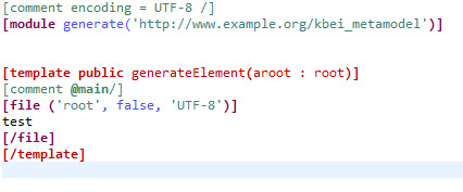

this is my code:
index.php/fa/37175/0/

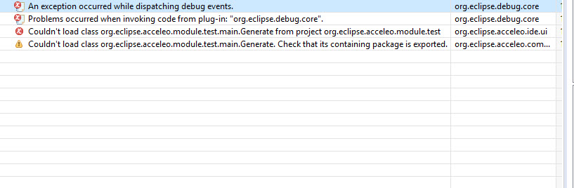

and when I chose Acceleo plug-in Application as Runner, I didn't get error in console, but there is not generated any code and I see these errors in error log.
index.php/fa/37174/0/
