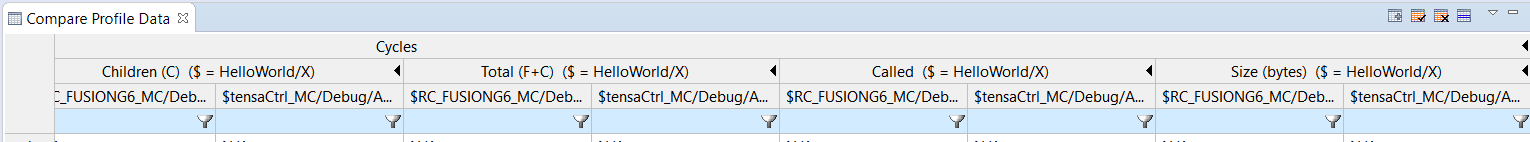

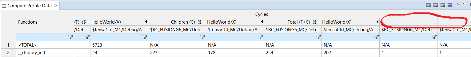

Currently, I am using NatTable 1.5 and using ColumnGroupHeaderLayer and ColumnGroupGroupHeaderLayer for displaying 3 levels of column headers. I want to switch to NatTable 1.6 and use performance ColumnGroupHeaderLayer. I replaced ColumnGroupHeaderLayer and ColumnGroupGroupHeaderLayer implementation with performance ColumnGroupHeaderLayer.
It worked, but last two column headers are not visible. See pic1 for reference. In pic1, I have marked with red where two group headers should appear - Called and Size. Also, if you see first column - Function - is freezed.

I have a BodyLayerStack which has following lines where I am freezing first column
SelectionLayer selectionLayer = new SelectionLayer(columnHideShowLayer);
ViewportLayer viewportLayer = new ViewportLayer(selectionLayer);
FreezeLayer freezeLayer = new FreezeLayer(selectionLayer);
CompositeFreezeLayer compositeFreezeLayer = new CompositeFreezeLayer(freezeLayer,
				viewportLayer,
				selectionLayer);
setUnderlyingLayer(compositeFreezeLayer);
The above works fine with earlier NatTable 1.5 implementation, but it doesn't with 1.6. One observation is, if I replace the underlying layer with viewportLayer instead of compositeFreezeLayer, it lays out all the group headers properly. See pic2 for reference, but I am loosing out the freezing functionality in first column (Function).
