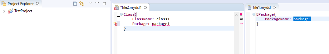

So if i am trying to refer the package in mydsl1 from mydsl, i am getting "Couldn't resolve reference to EPackage"
I have attached the Runtime xtext editor image.

EPackage:
{EPackage}
'EPackage{'
('PackageName:' packageName=String0)?
how does your qualified name provider look like
Re: Facing problem in cross references [message #1819567 is a reply to message #1819558] Fri, 17 January 2020 06:59 Go to previous messageGo to next message
I have not implemented any qualified name provider.
Re: Facing problem in cross references [message #1819570 is a reply to message #1819567] Fri, 17 January 2020 07:24 Go to previous message
xtext ill give only things a name that have an attribute name. yours does not. see https://www.dietrich-it.de/xtext/2011/07/16/iqualifiednameproviders-in-xtext-2-0.html
