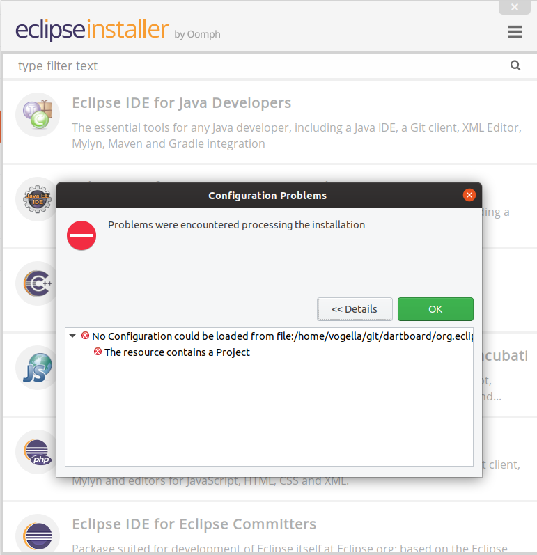

Is it possible to have one setup file which defines the product and the project (which can be dragged onto the simple mode)?
Currently if someone wants to contribute to Dartboard he first needs to select a product and afterwards can add the project setup file via DnD. If he drag the file on the wrong location or page he gets an not so telling error.
index.php/fa/37124/0/
I think it would be nice if a user could simply drop one file onto the simpler mode and gets a fully configured Eclipse with the project setup.
