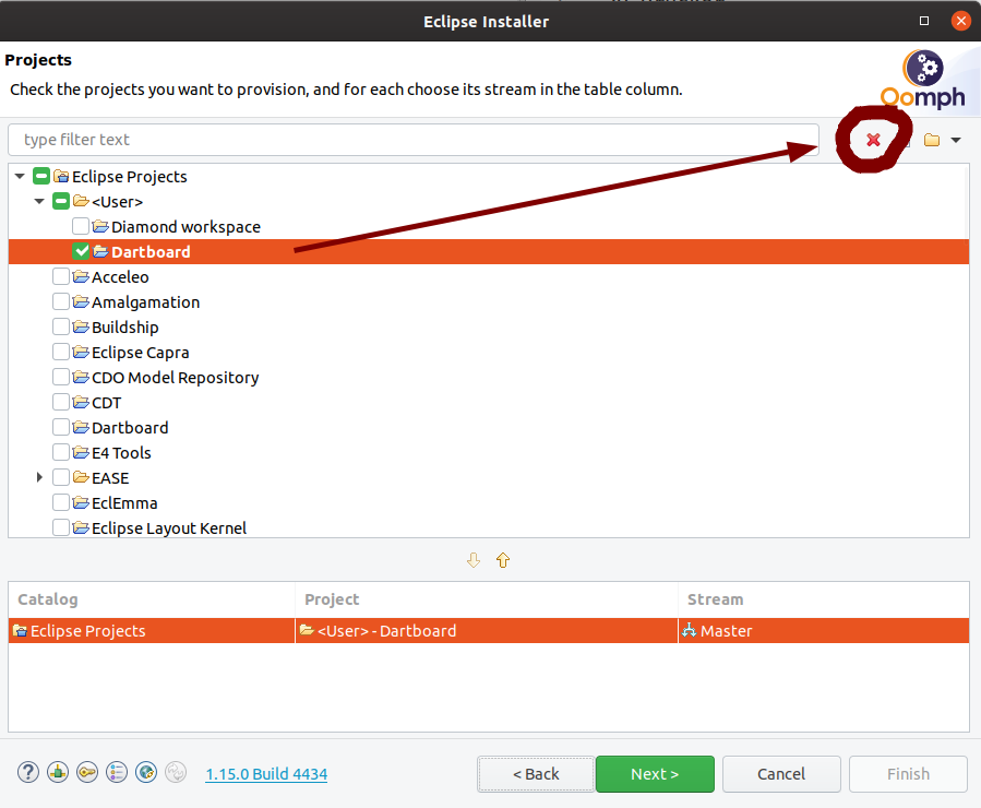

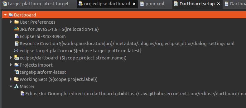

index.php/fa/37121/0/
3.) I removed the p2 task in the Dartboard.setup file, saved and DnD again to the Installer.
index.php/fa/37122/0/

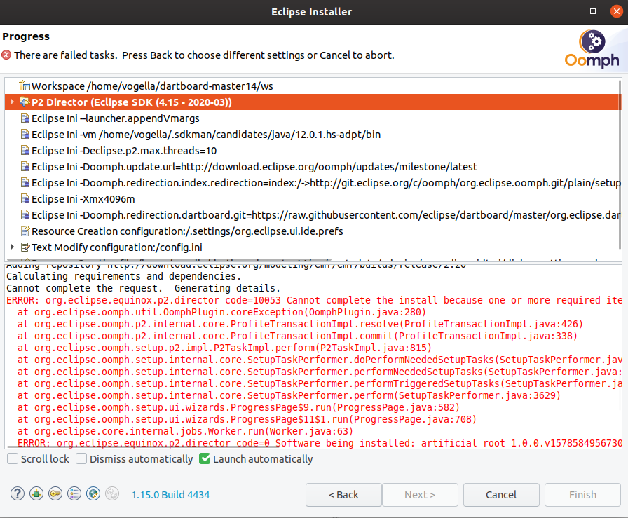

4.) Running the task resulted in the same p2 error, even though this task is not present anymore in the Dartboard.setup file.
index.php/fa/37123/0/
