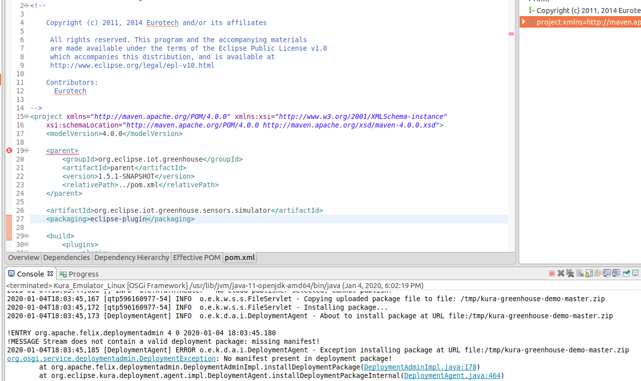

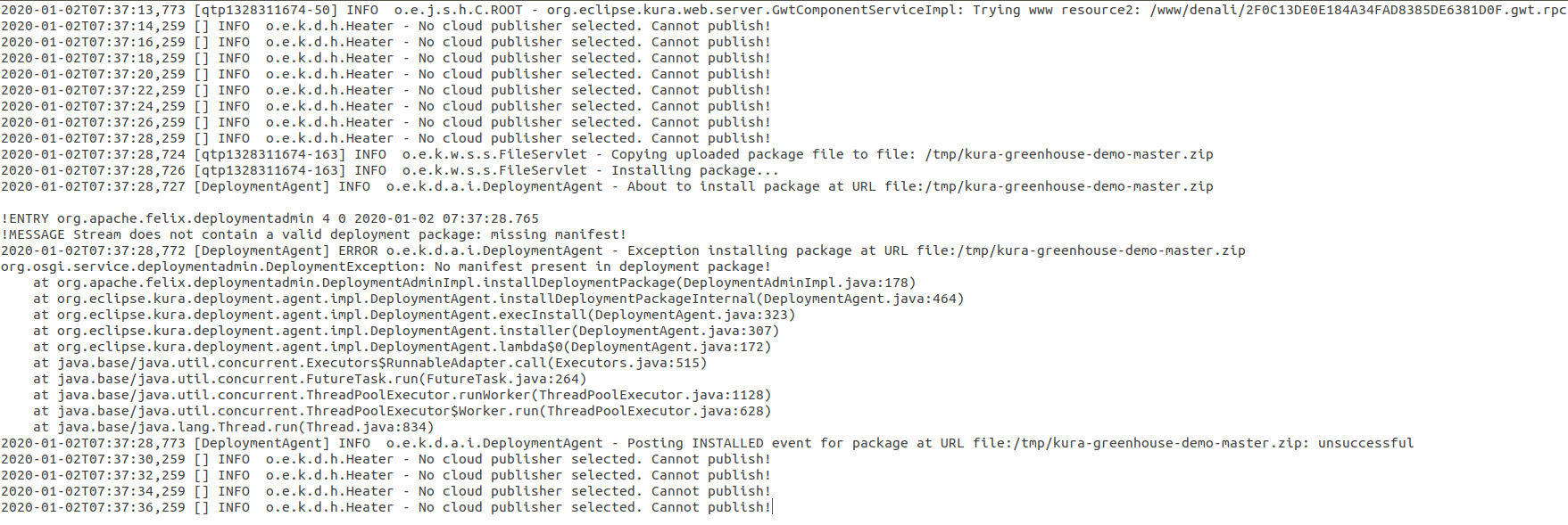

Hello, I am new in this field and I wanted to ask your help about the issue I am facing . I am trying to install kura-greenhouse-demo using KURA_4.1.0 UI. I am using the downloaded zip file to install. But I get these errors:
I really appreciate your support.
Re: Failed to install deployment package of kura-greenhouse-demo in kura [message #1819226 is a reply to message #1819069] Fri, 10 January 2020 04:00 Go to previous message
Kura is able to manage .dp files that usually contain the resources (jar files) that will be executed.
As I see, you are providing to Kura a zip file that probably just contains the source files of the project.
Furthermore, as reported in other issues here in the forum, the greenhouse example is not working with newer versions of Kura. You should use Kura 1 or Kura 2.0 with that.
Matteo
