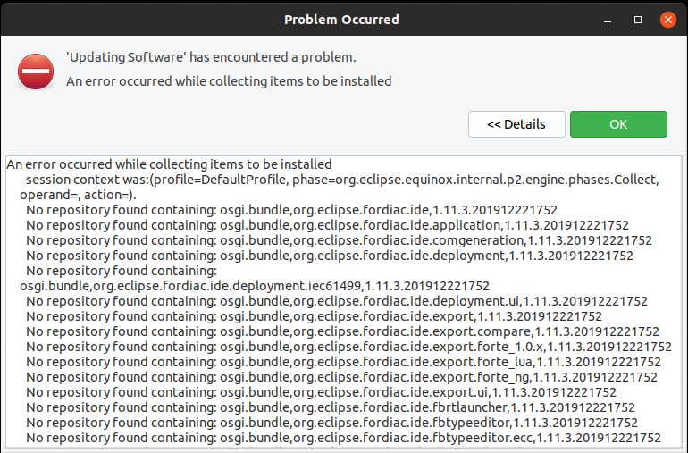

Hi, I am currently running 4DIAC 1.11.2 under Ubuntu 18.4 and I am getting errors while trying to run the automatic updates. Am I missing a setting somewhere? The images attached show the errors that are being reported.
I searched the forum but I could not find a similar error being reported.

Details from the error report:
index.php/fa/37074/0/

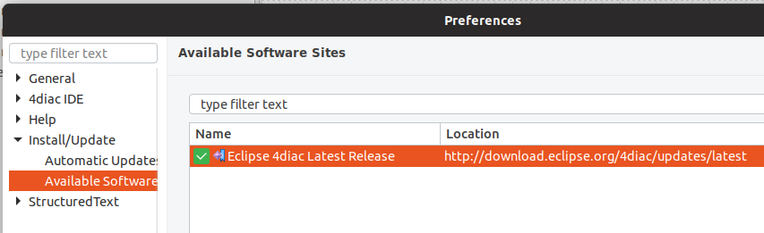

Hi Kirill,
Thanks for the suggestion. I already have that setup correctly in the Install/Update options but it looks like when I run the update, it is not using that preference. Most strange...
index.php/fa/37075/0/

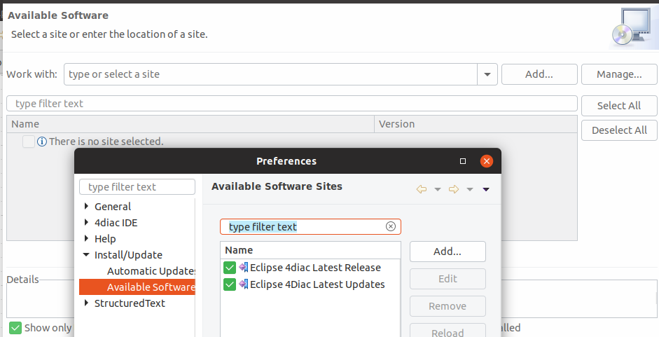

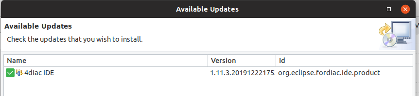

Re: Problem with updating 4DIAC to the latest release [message #1818933 is a reply to message #1818924] Thu, 02 January 2020 21:05 Go to previous messageGo to next message
Issue solved or partially so.
Thinking more about what Kirill suggested, I added the site https://download.eclipse.org/4diac/updates/latest/ in via the Help | Install New Software menu option in 4Diac. The update worked fine so it is not an issue with the update site.

index.php/fa/37076/0/
