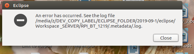

Workspace mix-up and how to recover from it ?
I am not sure what caused this , but that is immaterial.
I am asking the group assistance HOW to recover from this error.
I can access the log file, but it is HUGE , not really showing current date (?) AND most of all does not offer a solution.
I suspect something to do with "busy" workspace - which is "common" error I get and it is easy to recover from by switching / changing / selecting another workspace. NOT AN ISSUE.
But the "log" error give me NO OPTION but to quit Eclipse.
There ARE NO OTHER OPTIONS PRESENTED to restore current Eclipse run - except to run ANOTHER working copy of Eclipse .
HOW do I restore THIS , error giving , Eclipse (version) to normal operation ?

Re: Error recovery ? [message #1818914 is a reply to message #1818907] Thu, 02 January 2020 00:52 Go to previous messageGo to next message
It looks like you didn't delete the .log file first. Somehow the line numbers seems a little off for the 2019-12 version so it must have a NPE here at 2098 (rather than 2099, which can't have an NPE):
https://git.eclipse.org/c/platform/eclipse.platform.resources.git/tree/bundles/org.eclipse.core.resources/src/org/eclipse/core/internal/resources/Workspace.java#n2098
This suggests to me that your workspace tree is corrupted. I think it will be trying to read <workspace>/.metadata/.plugins/org.eclipse.core.resources/.root/*.tree and that file is corrupt. There might also be a *.bak in that folder, which is would read if there's an IOException will reading the *.tree, but there's an NPE so it never tries to read that. I doubt deleting the *.tree will help, but if there is a *.bak, that might help recover the workspace. Failing all that, you'll need to create a new workspace and import the old projects into that.

There are still many "Sessions" in this .log. The newest is !SESSION 2020-01-01 08:43:49.188 and that's the one where it's having trouble restoring the tree. That workspace is probably hosed, for whatever reason, so it is no doubt best to create/use a new workspace. I don't generally expect that an update of the IDE will hose the old workspace though, but once you use a workspace with a newer IDE, it might no longer function with an older one.
