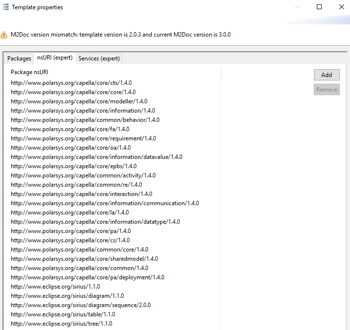

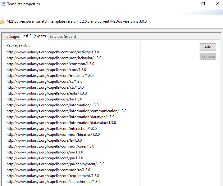

I edited the template properties to replace the old 1.3.x package URI by the new ones:
Old Package URIs
index.php/fa/37062/0/
New Package URIs
index.php/fa/37063/0/

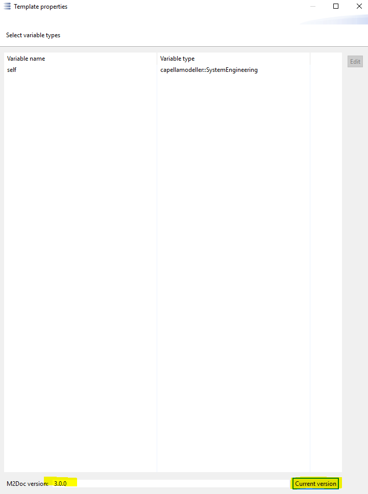

Then I Click on "Current version" which I suppose indicate I want to use the new version for my template.
index.php/fa/37064/0/
When finally proceeding, I have the following error:
An internal error occurred during: "Saving template".
Fail to save: an error occurs while saving the package : The part /docProps/core.xml failed to be saved in the stream with marshaller org.apache.poi.openxml4j.opc.internal.marshallers.ZipPackagePropertiesMarshaller@420c0d07

Re: M2Doc template migration [message #1818963 is a reply to message #1818883] Fri, 03 January 2020 10:55 Go to previous messageGo to next message
This error can happen under Windows when the template is already opened with an other editor. Otherwise you are doing what is needed to move from Capella 1.3.x and M2Doc 2.0.3 to Capella 1.4.0 and M2Doc 3.0.0.
Re: M2Doc template migration [message #1818964 is a reply to message #1818963] Fri, 03 January 2020 11:03 Go to previous message
You were right. I retried just now and it worked.
