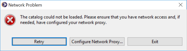

I'm running into an issue with installing Eclipse 2019-12 on a Windows 10 workstation. My first issue deals with the install file itself (eclipse-inst-win64.exe).
I receive an error that reads in part "The catalog could not be loaded. Please ensure that you have network access and, if needed, have configured your network proxy".
Unfortunately, I'm not in a position to reconfigure our network proxy to complete the download. Does anyone know where I can get the complete installation that doesn't require the application to reach out to the web?

Re: Eclipse Installation issues. [message #1818771 is a reply to message #1818767] Fri, 27 December 2019 15:47 Go to previous messageGo to next message
The Download Packages link directly under the larger Download button, to https://www.eclipse.org/downloads/packages , has some predecided combinations.
Re: Eclipse Installation issues. [message #1818780 is a reply to message #1818771] Sat, 28 December 2019 02:01 Go to previous message
Did you try the Configure Network Proxy... button? Typically even a Browser will require you to configure the way the network is accessed and it should be possible to configure the installer the same way. And note that this does not involve reconfiguring your actual network but rather entering the information needed to access the network through the proxy.
Also note that the installer will copy these network settings to the installation it creates. If you can't get the installer configured to work, then even the package you download (via a Browser that you must have configured to access the network through the proxy) and unzip will also not have network access so you won't be able to update or install new software in that IDE, which will also be very annoying.
