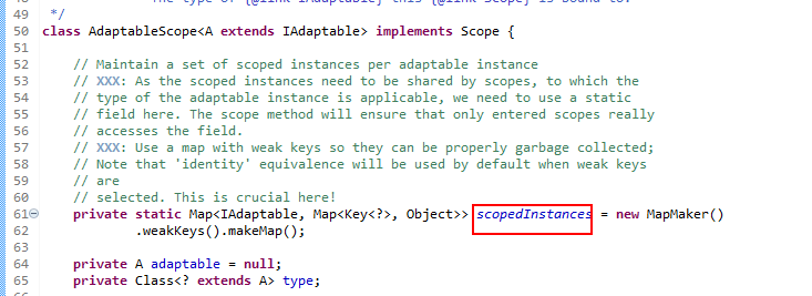

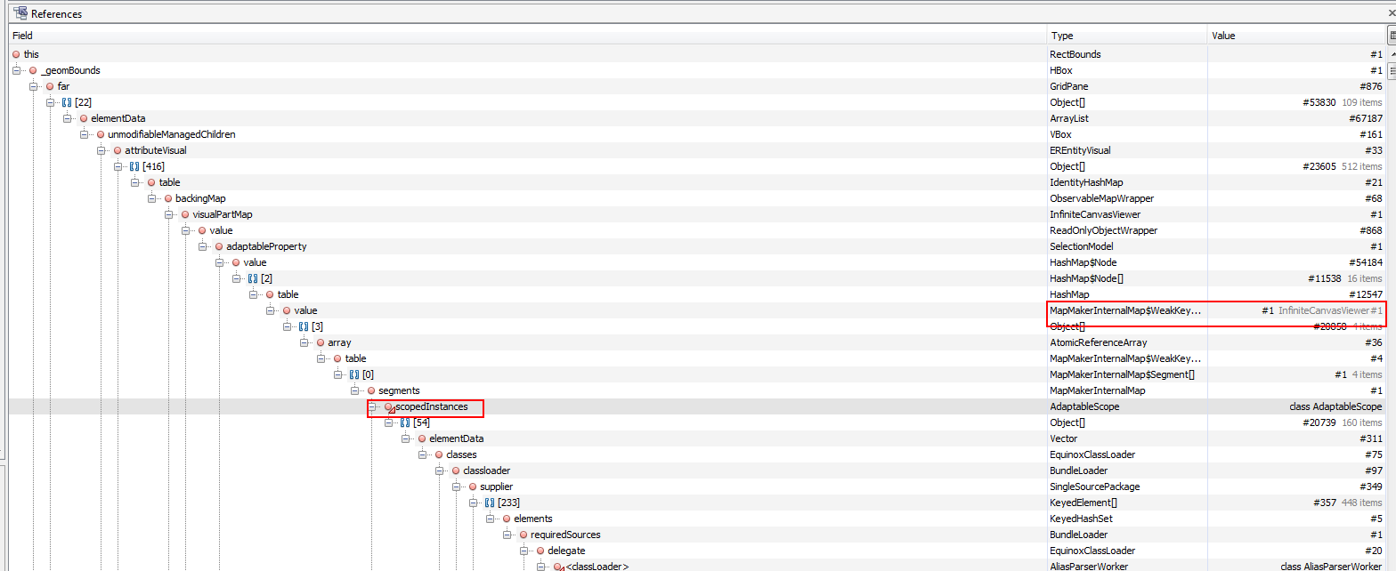

the picture gc_root.png shows the jvisualvm gc root tells who is holding the reference of javafx objects(like ).
com.sun.javafx.geom.RectBounds,
javafx.beans.property.SimpleObjectProperty, Node, BoundingBox, etc..
From the gc root all these are referenced from scopedInstances of
org.eclipse.gef.common.adapt.inject.AdaptableScope class.
Please help me to get around this issue.

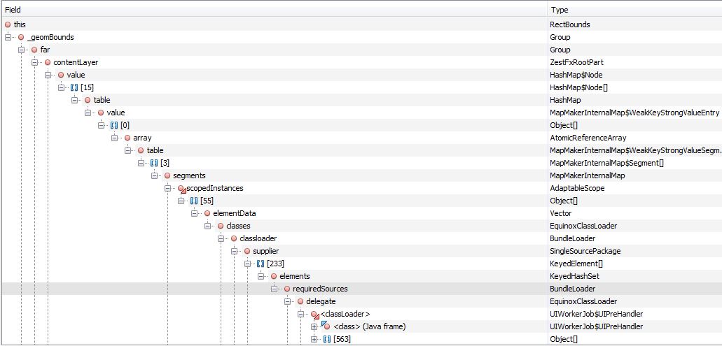

As you correctly pointed out there was 1 viewer reference which was not cleared in the previous gc_root image that i posted.
Now, I cleared the viewer refernce, but still the issue persists.
Please refer attached gc_root image after viewer cleared.
Giri
